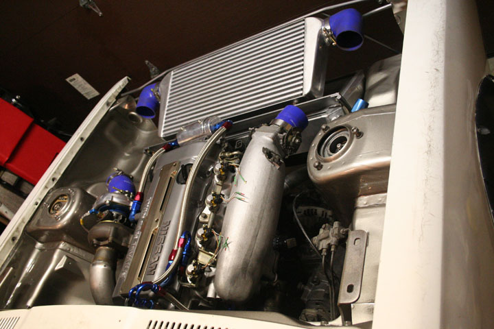

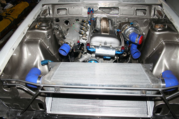

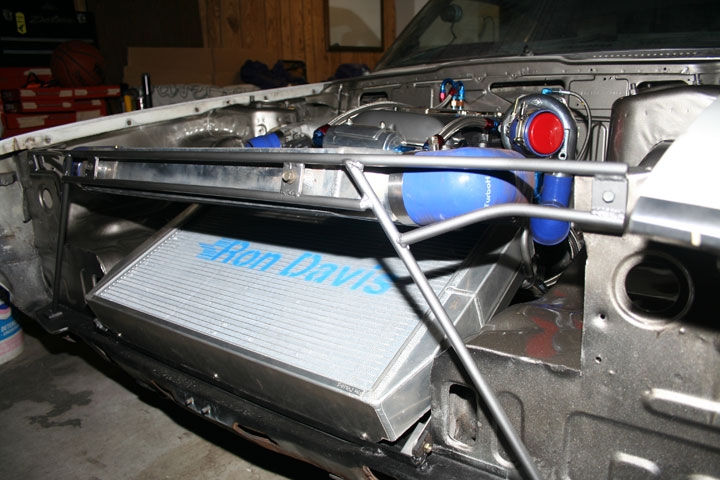

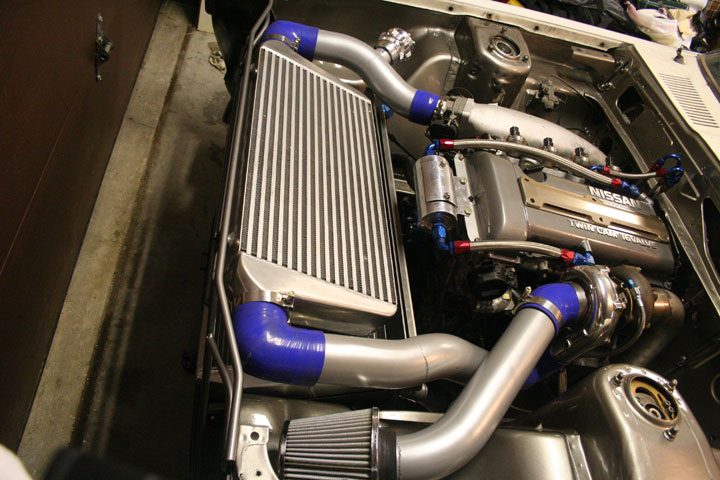

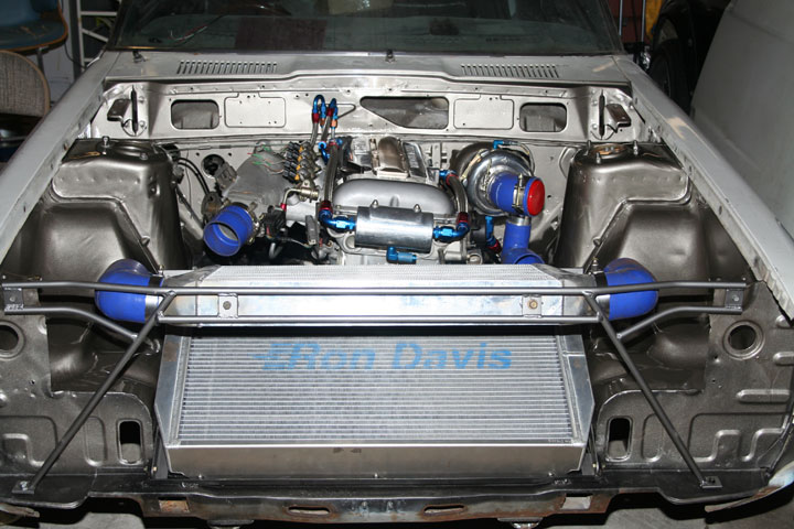

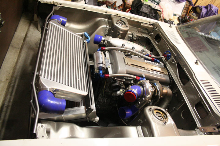

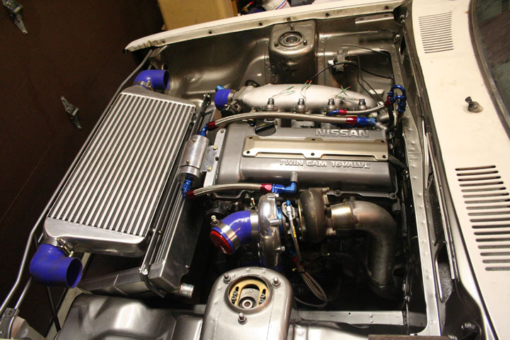

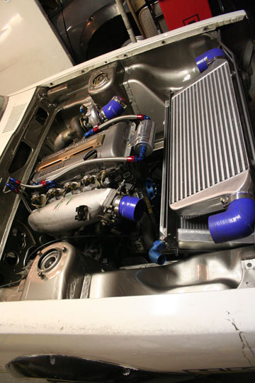

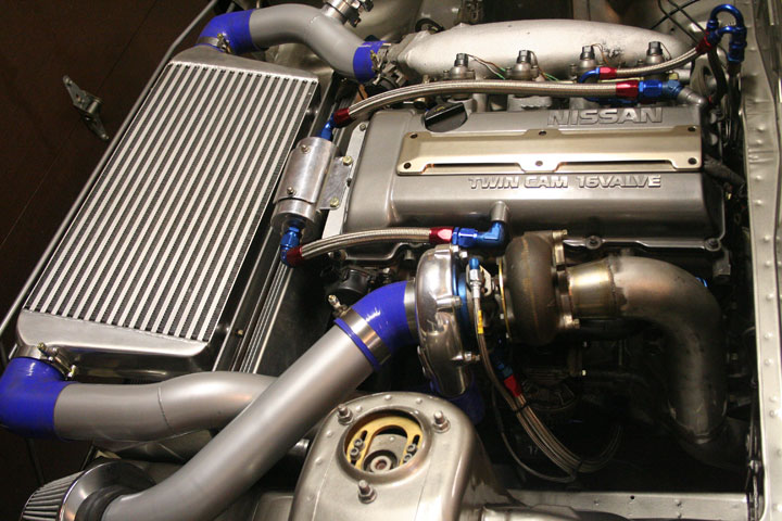

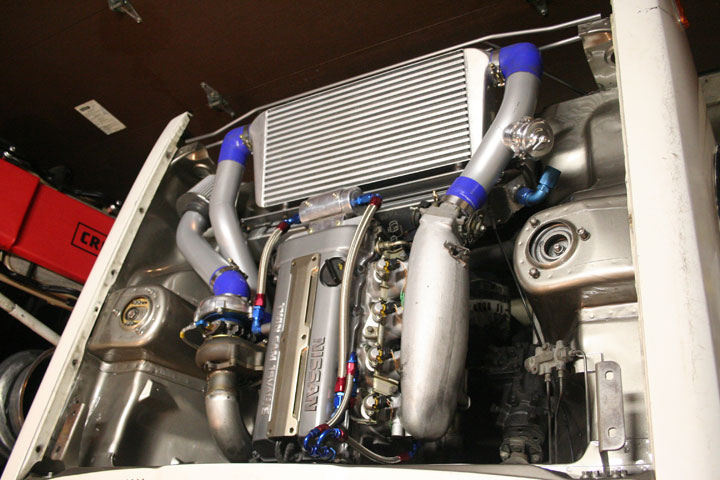

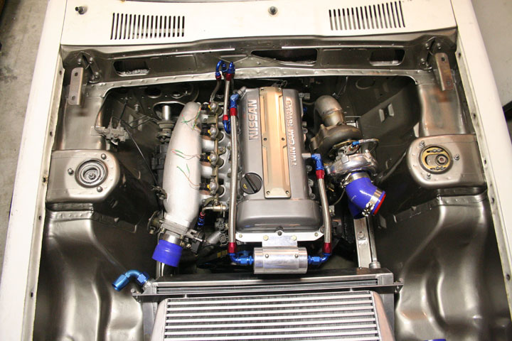

for those who have waited to see how my skyline would turn out fitted with the SR20DET motor...here you go...took a long while but its done....next on the list...Microtech ECU install and dyno time and the smell of C16 gas. ill update later.
thanks to all who have helped me

Fine looking project, however and I am sure you have it all worked out, make sure that the head is not higher than the filler point of the radiator, or you end up with air bubbles in your head. Another thing to remember with the SR and a system like that where the return to the radiator will not flow down into the motor, you really need to backfill the system with coolant first, or its not a pretty result.
Awesome car though.
Chris
Hi Mikey, that a VERY hot project that you have there :)
About the head being higher then the radiator - sometimes it cant be helped, a way around it to have a "header tank" mounted elsewhere in the engine bay and plumbed up to the radiator and various other places so that way its all apples in term of cooling.
Cuong
i do have the header tank...just not installed as of yet...i will surely add the coolant first,,thanks
as for the grill, lights, bumpers, etc...will be and easy fix...all need to do is make tabs and weld them to the new core support. will do all when i get the parts from lachlan.

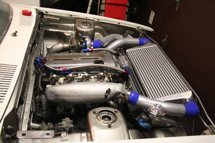

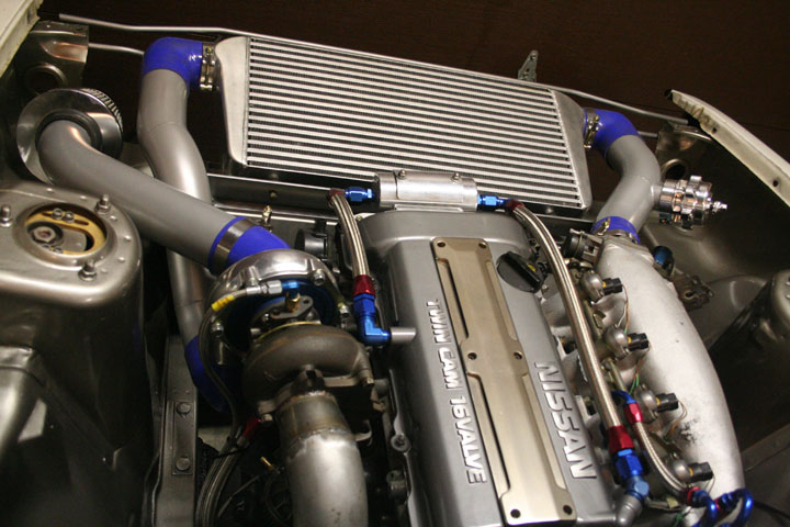

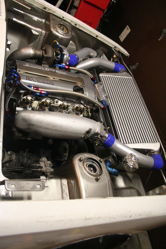

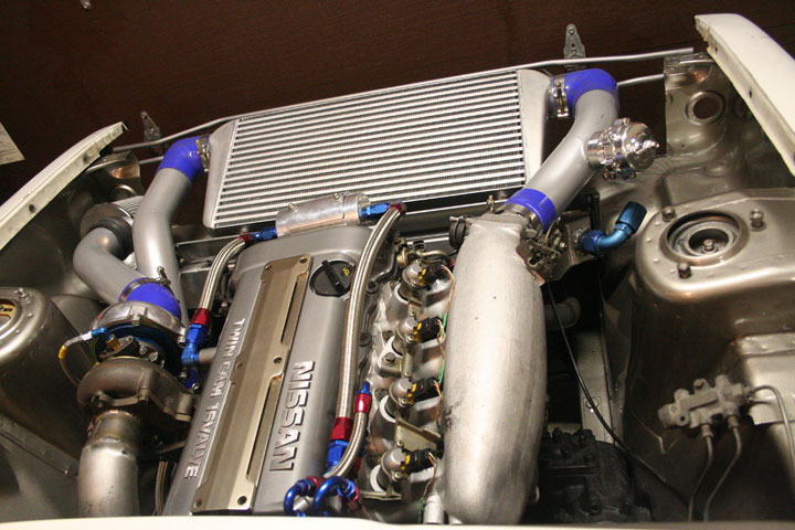

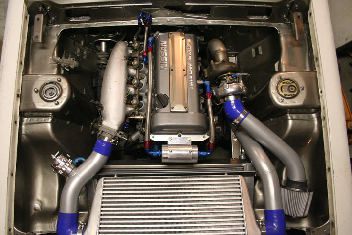

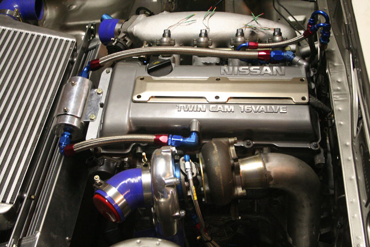

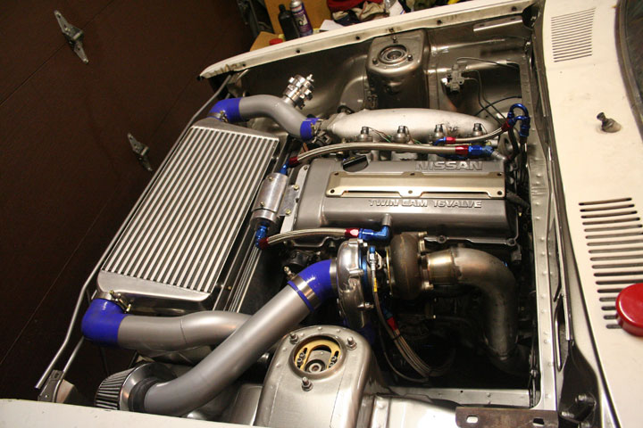

heres a few more pics with the intercooler pipes and blow off valve
mikey
