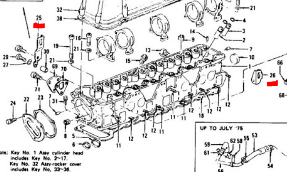

This is  my 1st engine pull in many years, where would you put the chains on the block   ?
5 hours ago, Zed Head said:
This is a good point, and it's after you drain the transmission fluid.  In case you were thinking you could pull it with the fluid in.  As things tilt, there will be residual fluid draining.  You could leave all of the fluid in but you'll need a much tighter seal.
You'll probably need to remove the console also to get to the shifter.  The propeller shaft bolts will be hard to remove, but should be since you'll want the prop shaft off before pulling.  You can leave the slave cylinder hanging.  Remove the radiator, don't try to finesse the engine out with it in.  Take pictures or mark your parts with tape.  Use ink that won't rub off with greasy fingers, or put the label inside the bag.  There's a lot of small stuff that could/should be done before even hooking up the hoist.
A few thoughts in case it's your first time.

Since your manifolds are off you've lost at least one slinger.  Their general positions are shown in the FSM though.  Make your own and bolt them tightly to the head.
