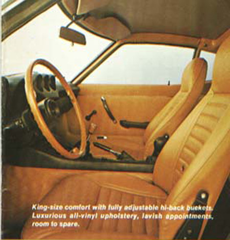

Yes! I am aware of the plastic seat cusion guards. Kats has the only car I have seen with them installed. I am a little seat impaired at the moment. I need whole seats as well as seat parts, but seats are way down on my list of appropriations as I focus on the body shell and suspension. I need to get a rolling chassis before I can think about sitting in it!
Here is where I am headed, though. Original seats had metal vent grommets (4) in the seat back lumbar area. You can almost see one of them in the picture. They get very hot in the florida sun - believe me. My ex-wife has one of those cute lumbar tatoos from them. ROFL
