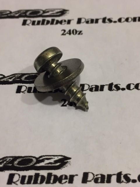

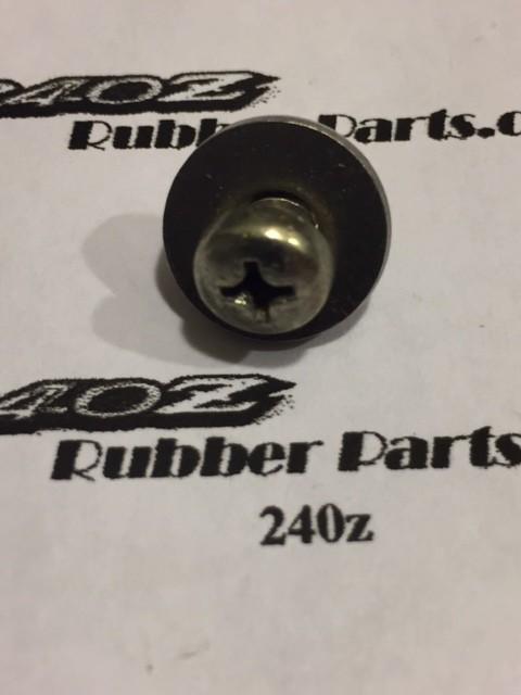

You show two different hardware sets, Kats.  Which one do you think is most correct?  Black screws or plated screws?
I'll have to dig mine out but I think all mine were silver not black. The washers could have been cad plated but I don't think so.
Sent from my [device_name] using http://Classic Zcar Club mobile

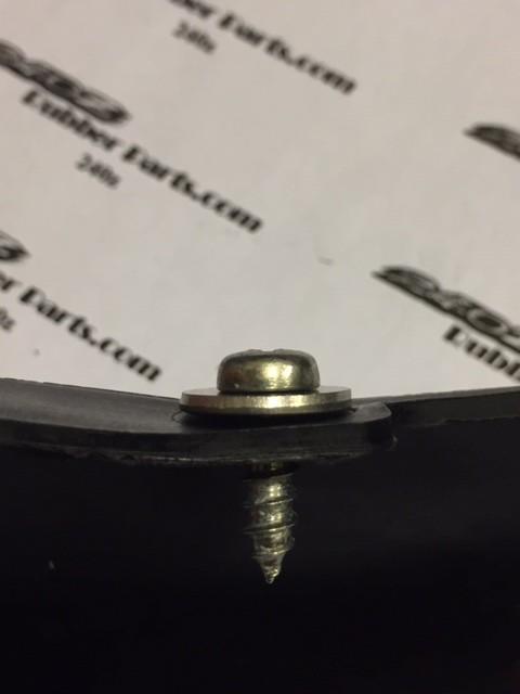

update: I located some thicker style washers and will recheck screw size when I get the washers.
The washer is a m5 and looking at Kats pictures and the size of the seat guard holes, the screw looks like a #8 x 3/4. I used a 9/64 drill bit for the new holes.

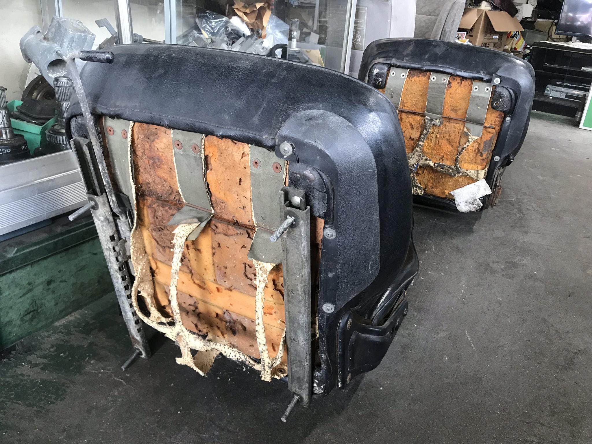

Here is an answer, you can see originals . The two really bad shape early seats have a silver screw and a silver washer. The detail can tell you they are not obtainable nowadays, the shape of the head of the screw is something different, and the washer looks a little bit thicker than currently available at a home depo .
And in March or April 1971 ? A set of new seat belts and hook were applied,I guess that time was a change of the seat too , the seat bottom would have lost the guards and , the seat back lost the hook which transferred to the body side interior trim .
And I assume the change of the seat back would be made at this point ,  “ fat seat back “ replaced by “ narrow ( slim ) seat back “ .
It is going to be interesting that everyone look into the seat bottom frame  , if you find the holes for the guard , is it March or April 1971 or later ?
By the way , an early seat back has a hole for the seat belt hook , the hole can be seen both side right and left for the efficiency of the production. I will check my seat bottom frame if it has holes for the guard both left and right.

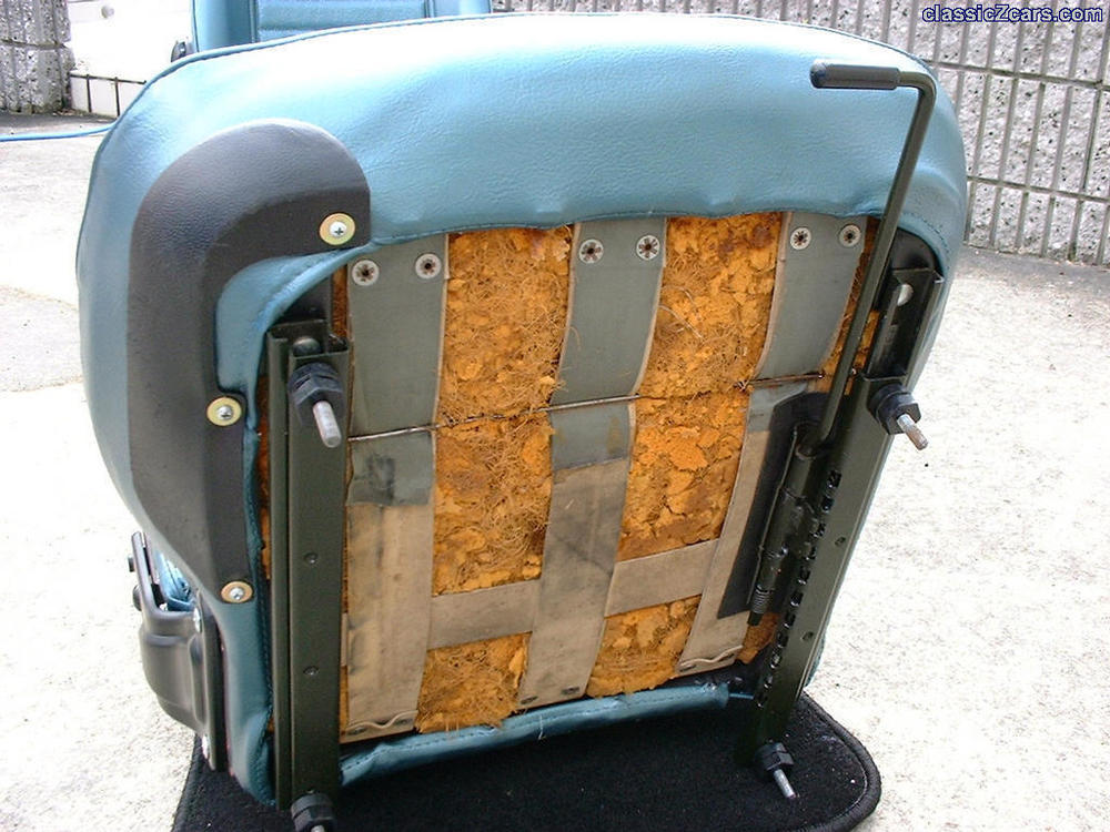

Hi Keith , I was going to ask same thing to Steve  as I also want the light green cloth for my seat restoration . Great work Steve !
Here is a picture of the screws and washers for the plastic guard, they look special for me .
Kats

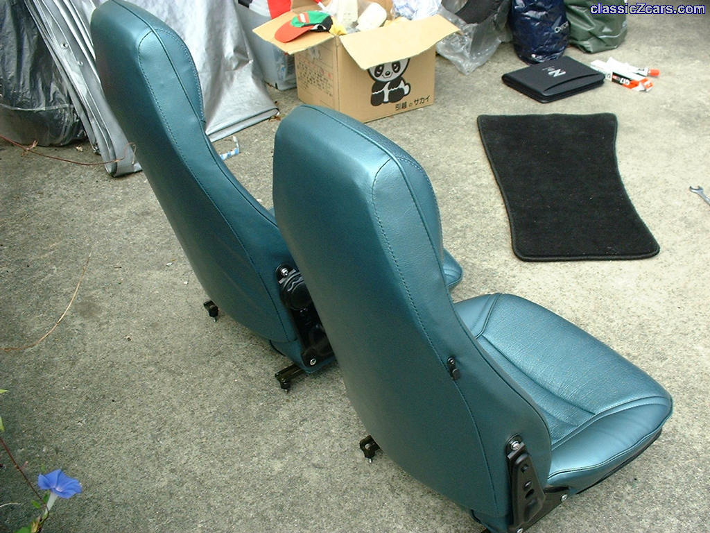

I will have my blue seats re- trimed again , Mr. Sudo offered me that making my blue seats fat seat back , now they are appeared in slim type . Using an extra blue vinyl which he gave me is going to be wonderful.
I think so too , my 03/70 car should  have a fat seat back. At that time ( in 2003 ) Mr.Sudo was not aware that because he just got an order from a car shop “ restoration of blue Datsun 240Zseats “ without knowing it is going to be installed for 03/70 car .
The black ones are  recently restored for my 01/70 Z432 , fat seat back .

Thanks Kats for pictures. I believe the washer in a M5 thick washer and a M5x16mm self tapping screw as seen in my pictures.
