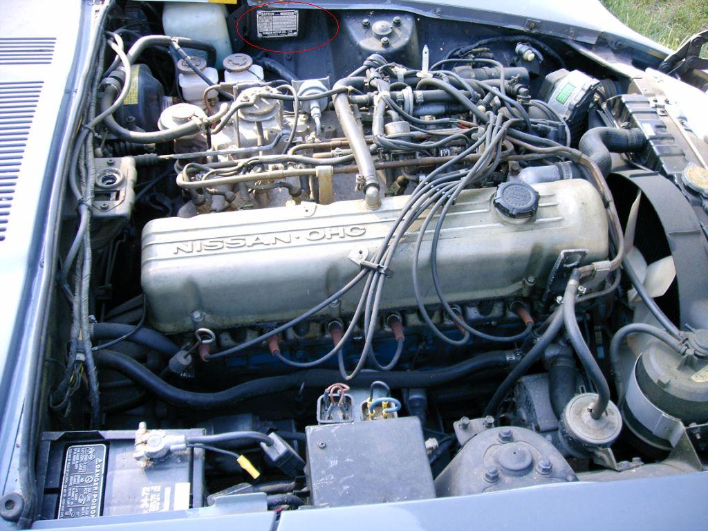

The VIN plate on the right front strut tower will have the engine number. The engine is stamped on that same side at the very top of the block above the starter. Just below the head, on the top face of the block. That's it. The VIN is stamped in the firewall, appears on the dash and the driver's door jamb which also includes the manufacture date. Various parts are dated and there is a seriously fun anal conversation in the archives about it.

Let's not get ourselves confused.. the VIN won't match the engine number.
The original engine serial number is stamped - not on the VIN Plate - but rather on a Data Plate under the hood (as Chris mentions above) - it's a shiny metal plate about 2"x 4" and the original engine serial number will start with "L24-"......
Your 73 240-Z would have a Date Of Manufacture (aka build date) of 07 or 08 of 1973. That information is stamped on another Data Plate that is affixed to the Drivers Door Jam.
Now - go look more closely at the engine number stamped on the block... On the block there are two flat pad's cast into the block - the first one should be stamped "L24" Is it?
The second one might be
182194 rather than the 082194 you reported...
If the serial number stamped into the block is actually 182194 .. it might be the same number as is stamped into that Data Tag under the hood.. As that is in the range of the engine serial number sequence used in 07/08 of 1973...
If the engine is actually stamped with L24 082194 it is most likely out of a Z built O2/03 of 1972.
What is the serial number stamped into the Data Tag on your Z?

Virto, that's a 280Z and you're showing the left front strut tower. I believe that it would be on the right front strut tower on a 240Z as Chris stated.
Crap. Just when I think I know what I'm talking about.
Well...take that picture and mirror it in photoshop, you'll get the idea...LOL.
