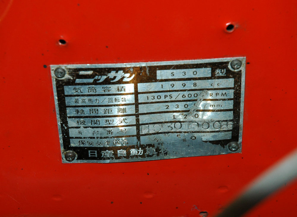

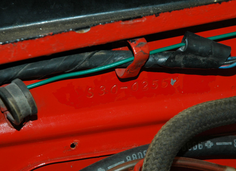

The vendor does himself no favours by continually claiming that this is "Chassis 26" and "HS3000026" when it has been re-shelled and the original Works-built ( and very special ) bodyshell had been cut up and thrown away before he purchased the car. They didn't even bother trying to re-stamp the firewall VIN ( it still las the original Fairlady Z body number ) and the engine-bay VIN tag was simply overstamped with proprietary number and letter stamps - badly.
I still can't understand why the vendor insists on calling it 'the real thing' when it quite patently isn't the car that some of its parts used to be attached to - if you see what I mean. Surely it would be much better for all concerned if this was honestly described as having been re-shelled?
I took some photos of the car at the Bonham's auction, and have attached a couple here to illustrate the body number and VIN tag issue:

It gets worse. The vendor's response to the latest questions asked is revealing:
"THE CAR IS THE GENUINE ARTICLE I HAVE ALL THE fia PAPERS FOR THE CAR AND THE LOG BOOK STATING THE CHASSIS NUMBER OF WORK CAR 26 .The car purchased by Bradburn Brothers ltd in 1983"
Yes, he does have the old DVLA-issued V5 for 'PTD 524K' ( the UK vehicle-registration number that was allocated to chassis no. HS30-00026 after its Japanese temporary-export 'carnet' registration number ran out ) - but the big problem is that he does NOT have the correct car to go with it........
The car has been re-shelled into a 1970 Fairlady Z body. This re-shelling was performed by Bradburn Brothers Ltd before the present owner bought it. He may have been convinced that it was the genuine and uncorrupted article when he purchased it ( who knows? ) but it is NOT 'HS30-00026' any more, and should NOT be described as such. End of story.
The FIA papers shown with the car at the Bonhams auction are not peculiar or specially-linked to this car in any way. They are simply copies of the FIA homologation no.3023 which are still available to buy from the FIA by anybody.
I've been contacted directly by a couple of people asking me if this could possibly be the 'real' car........ Surely just checking out those pics of the firewall VIN number and re-stamped VIN tag should be enough to settle the issue?
