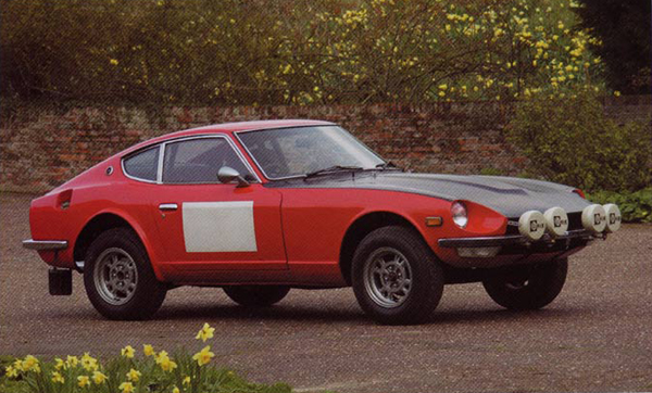

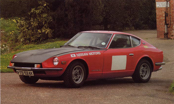

Well, I wouldn't say it was "half there" quite yet. In fact, the vendor is simply quoting some of the things that were written in the Bonhams sale catalogue - so nothing new there - but still can't get the story straight. Some observations:
I have contacted the owner and have hopefully got tho the bottom of this. The car had been rolled by Roy Fidler and was re-shelled by Bradburns the chassis plate from 26 was then transferred (this plate bearing original Japanese characters, had been overstamped prior to Bradburns ownership) Fia scutineers would not have been able to read this.
The vendor is saying that "the chassis plate from 26 was then transferred" - but the plate on the car now ( as can be seen from the photo I posted earlier ) is categorically NOT the original VIN plate from HS30-00026! It is the original plate from the Fairlady Z shell that the car now uses, and was OVERSTAMPED with the number of HS30-00026.
What's this nonsense about FIA scrutineers "......would not have been able to read" the Japanese characters on the original VIN plate? Note:
FACT: The original VIN plate of 'HS30-00026' was an 'Export' type VIN plate, written in English.
FACT: The original VIN plate of 'S30-02552' ( the Fairlady Z body that is being sold in the auction ) was a 'Domestic' type VIN plate, written in Japanese. THIS IS THE PLATE THAT IS STILL ON THE CAR - and has simply been overstamped........
The vendor is again telling a story that doesn't add up, and you don't have to be Sherlock Holmes to see what has been done here. The facts speak for themselves.
Bradburns re-jigged the car and fitted various new body chassis part to complete the rebuild. ALL of the parts from the original shell (which was scrapped) were transferred to this shell and the car then competed in further events in the hands of J Bradburn.
The car being sold is actually fitted with a mixture of standard road car parts and ex-Works rally car parts, but many of the ex-Works rally car parts are of later vintage than the original 1970 RAC Rally spec.
Many of the parts from the 1970 Fairlady Z 'donor' car were retained, such as the steel tailgate, all glass windows, standard dashboard, standard pedals and pedal box, for example.
If the vendor had started out with a totally upfront and honest description of this car, many of these things would not be a 'problem'. It is a very interesting car, with some wonderfully rare and interesting parts attached to it, but it is categorically NOT HS30-00026.............

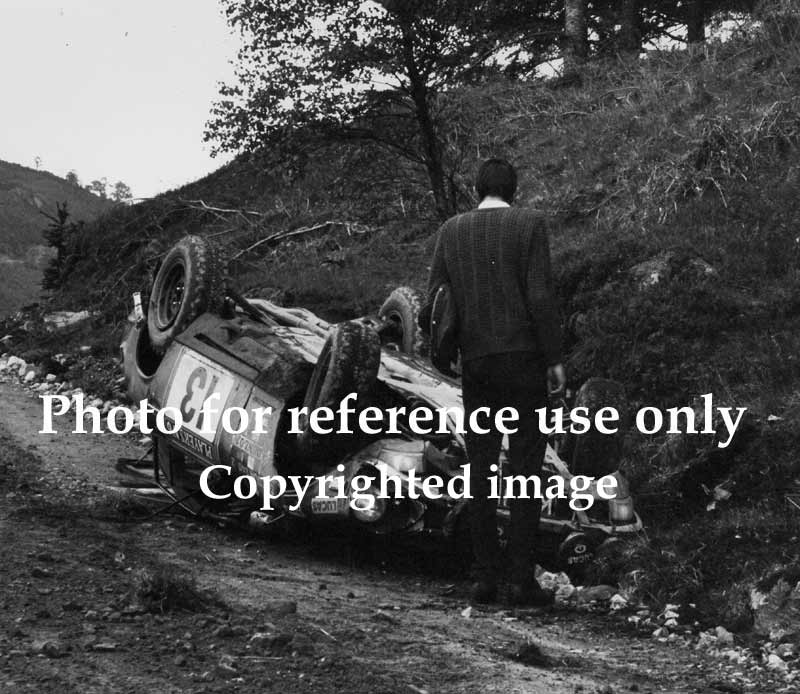

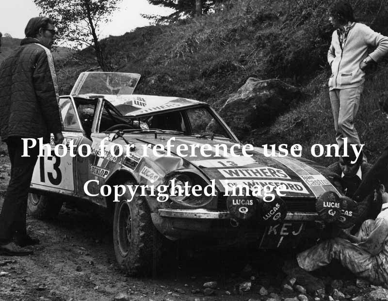

.........And this is what happened to the real 'HS30-00026'..........
Hi Alan:
I can see that the car is damaged... but please tell us the "story".. who are the people in the picture, where are they and what were they doing just before the road side stop .... and how did they get the car to begin with.
thanks,
Carl

I have a question.
I thought that the early Z's had fiberglass head lite buckets like my 71? The car in the pictures has steel ones since you can see them crumpled from the crash.
So did just the US Z's have fiberglass or maybe that picture was taken after the late model 240z steel ones where available?
