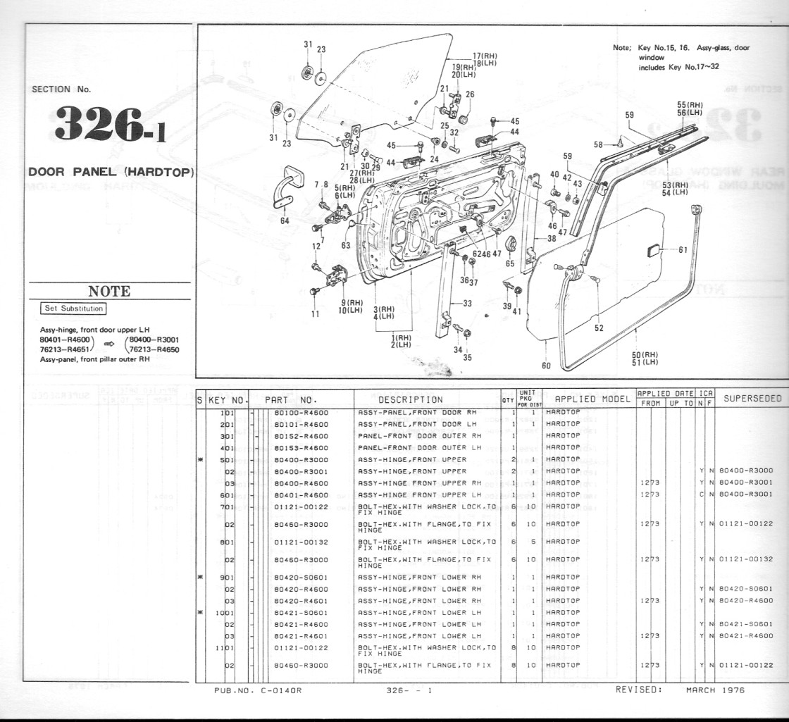

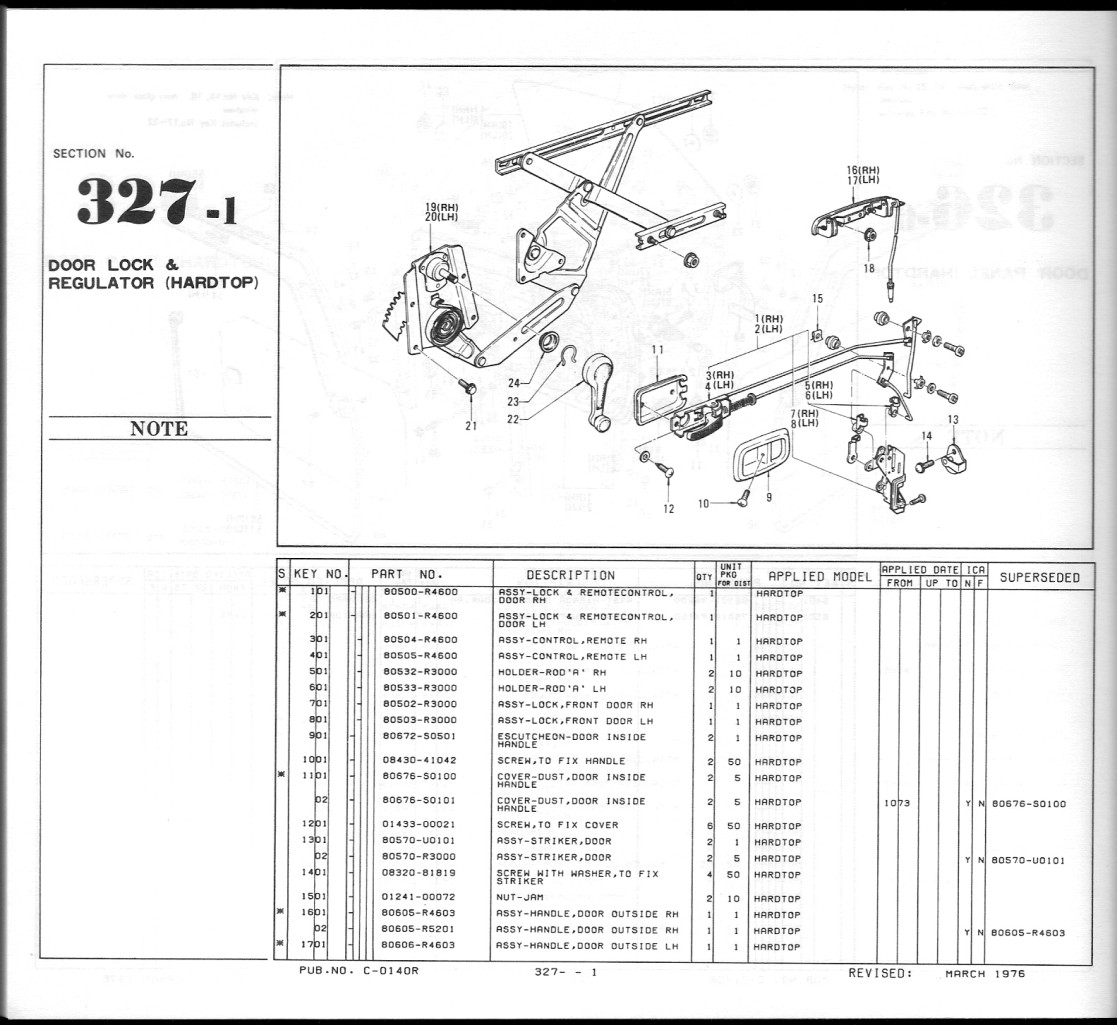

Yair...I was thinkin' the same thing Miles, so...just for 240KMan...here's the scan from the parts cattledog of the window regulator for the 240K GT and GL.
NO mention anywhere in this parts manual for power windows. I had a dig through electrical and options as well.
I've included a scan of the cover of the manual for reference
