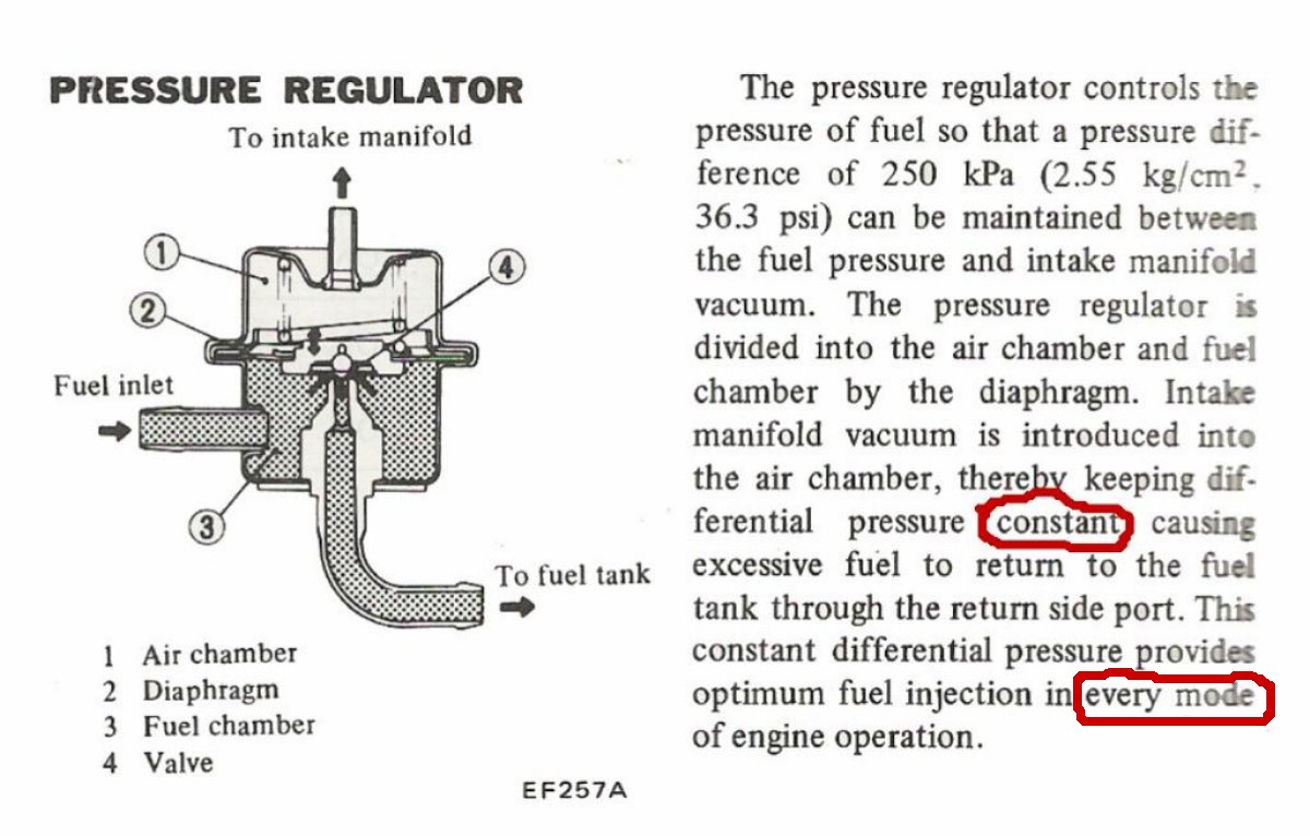

I'm not versed in Z EFI but I do know GM EFI very well. 30 psi at idle should be okay. The manifold vacuum is probably used to control fuel pressure at the injectors at any given rpm/load. If you gun the engine the fuel pressure should rise upwards to the 37-38 psi and then settle back down to 30 at idle again. When accelerating or cruising at high rpm's the fuel pressure is probably in the max range. A fuel pressure gauge in the cockpit would prove this. As a side note, NEVER run fuel lines into the cockpit for ANY reason! Only use an appropriate isolator! Fuel pressure dropping (it should hold for a few hours anyhow) quickly once the engine is shutdown is caused by one of three things, a bad check valve at the pump, a leaking injector, or an external leak. The last would be very obivous....
