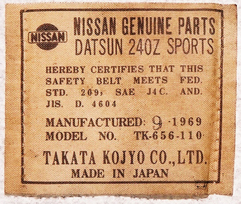

I'm also interested and researching. All three of my current vehicles are equipped with the series I buckle latch, as pictured in the first post. My 70 roadster, 71 521 and Z all have these buckles. From what I've learned, the finish is blast-dulled chrome. I hope to be able to disassemble the buckle for plating. I had hopes of reproducing the label. Unfortunately, All three cars use a unique label from the others, So it would be 3 one-off reproductions!

Yes! I made repro seat belt labels. From this original. A photographer friend of mine had some material from a sample kit he got of papers and textile media that was printable. I scanned the label, photoshopped a 8-1/2x11 sheet of them and laser printed the file on to the one sample sheet I had. I tried to buy more material, but they wanted $300 for a roll of it big enough to wallpaper my shop. Thus endeth my million $ scheme to eBay repro seat belt labels. I probably have over $70 in that exercise!
