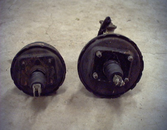

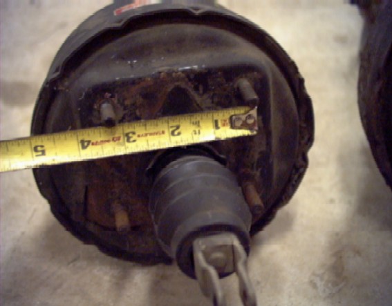

The early 240Z boosters had a smaller bolt pattern
than the later ones. The small one is the booster
from a 71. They say that you can re-drill the holes
but the booster bolts in to and secures the basket
that holds the pedals. The large one is a 280 booster
Dave...

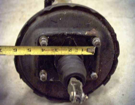

I just measured my booster on my '73 at 8 1/2 '' form the out side edge of the flange . Hope this helps . Now , this Z is an automatic. The space between two master cylinders may not allow this size so do measure first . Gary
My '73 is a standard transmission, built 1/73, and I believe the booster is the same size Gary is talking about -- see my photo. Outside diameter is about 8.5". The "unit number," in case not legible at this res., is 223-0 and then 1100 is stamped after that. Let me know if you need me to measure anything else or if you need a higher-res photo -- I think your life will be easier if you get the same size that came on the car.
