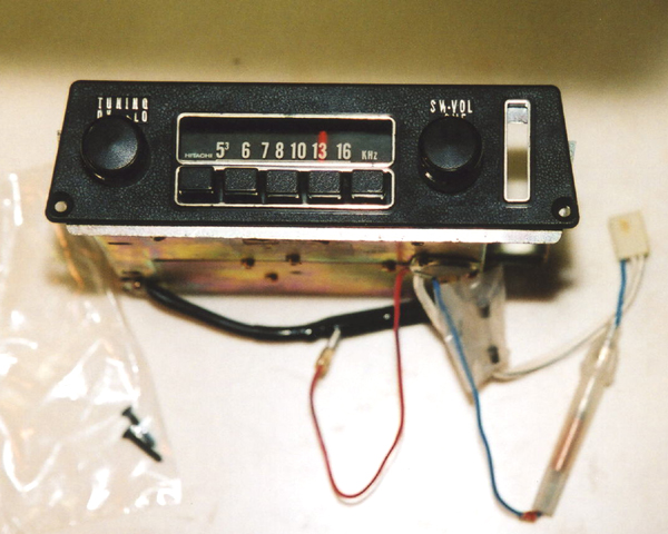

Nice Pics Chris, but I can't see that you have a need to refresh this face plate.

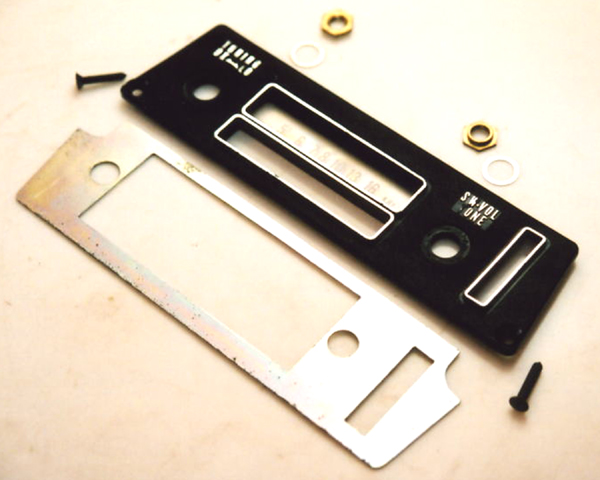

By the way Chris, that metal faceplate that's just below the plastic faceplate, it's face down. The cutouts on the corners are for the screws that hold the HCP to the car.
In your Hitachi-AM 5 pic, you can see that it extends BELOW the radio's faceplate, which it should NOT do.
E¢

I just have not caught the hang of photgraphing parts, Enrique. The focal length is all wrong. The lighting sucks. I'm getting better, but you would think I was some sort of photographic hack by looking at my parts pictures. Race car at speed - no problem. Gothic cathedral stone details on a cloudy day in Paris - no problem. Nudes on the beach at sunset - no problem. But parts on my work bench?
It's the same face plate. I assure you! This is the nice radio, not the restoration in question. Yes, the backing plate is upside down! It's just in the box that way. Hell, everything is in boxes!

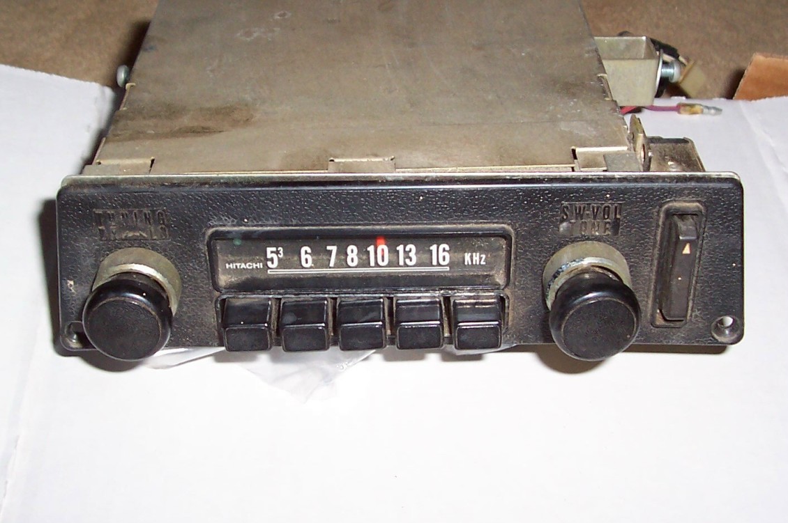

Chris, on this faceplate, (if it's a pic of one you own and not a reference pic) could you confirm that the chrome around the dial indicator and push buttons IS reflective (i.e. "true" chrome) as opposed to the silver SATIN paint that you see on the other surfaces? AFAIK the surround around the antenna switch is also Satin painted and not Chromed (shiny/reflective).

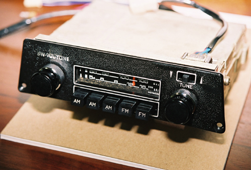

Your are correct, I have a '74 AM/FM radio. It does have the wrong (upside down) faceplate. I wonder if I can rework this radio to have the AM faceplate from my '71 on it? I wonder if I can modify it to use the old antennae switch. I guess I will have to take the AM radio out and see if anything will fit.
Chris: Where are you getting these great pics of radios? Here is a pic of my '74 AM/FM. Do you have a pic of the early '71 AM radio? I want to see if I can modify the '74 to fit the '71 antennae switch and faceplate. I just put an '81 AM/FM Rabbit radio into a '76 Rabbit. It was kinda the same thing.
