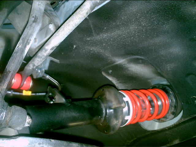

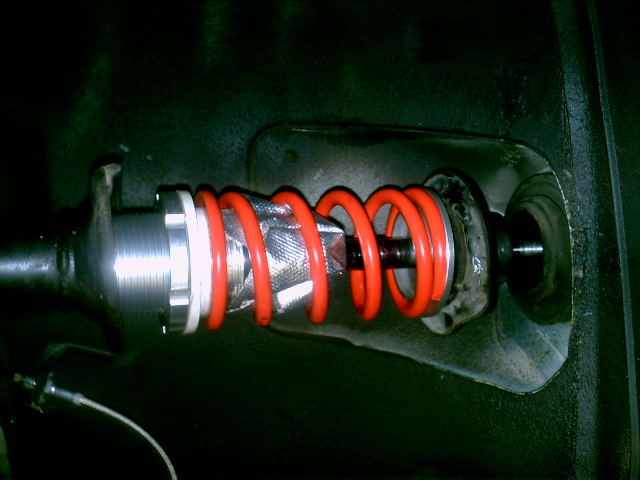

Well fellows here is my 2 cents.
I must be the 1977 280z experiment here without knowing much I had bought these off EBAY.
Fortunatly enough 4 me they appear to be alright (thanks cosmo) with very light if any modification. At first glance you want to cut at the top of the old oem bearing support and slide that onto the aluminum top that Cosmo supplied. So as far as the installation being "as advertised"? 4 me it is going well for the type of job we are talking about. It is my first time tackling suspension.(gotta man up sometime)
FYI-The illustrations in the cosmo manual showed more of a shock or rear type application but I surfed the net and found couple examples.
However we will see AFTER I load it all up and test drive, which will be a bit later. cURRENTLY I am replacing the bushings,brake pad,boots ...all that.
Thank god I am lucky lucky this was operated in Brea California who had an anal owner (like me now) for the last thirty years, I am enjoying going through this car with the factory manual.

It all went good, but unless you want to grind down all the speed bumps in your community I say set the new spring perch supports and lock rings flush to the top of the threaded standoffs.
The old struts and coils looked good ;but worked bad these should be nice with the KYB struts and bushing kit that I installed.
Later I'll do the rear,resting now because the new clutch slave cylinder wont bleed even with a power bleeder- probably will be fine after a nap.
All kidding aside it was pretty labor intensive the first time around but saved alot of bucks and bragging rights (anyone can pay a mechanic to do it)
