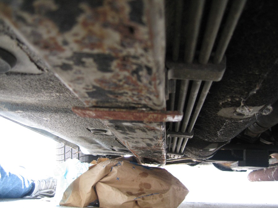

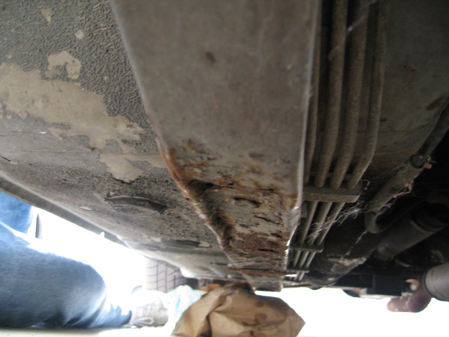

Anyways, I have attached some photos of the passenger side frame rail (it is rotted through) and would like to know the best course of action. I searched for past articles and couldn't find anything.
I plan on cutting away the rot, brushing away the rust, using chemical rust removal and Por-15 (sandblasting if I can find a place to do it) then welding on new frame rails. That's the short version.

I too will be getting my rust repair parts from Zedd Findings. I'm not sure if Charlie (the owner) sells the frame rails separately, but I know they do come with the floor pan replacements he sells. Definitely worth a call.
Thanks for the suggestions. I have seen Zedd Findings before and thought about going with them but found this site and liked them.
http://www.baddogparts.com/
They make a deal that fits right over the old frame rail and helps to stiffen the whole thing up. What's your thoughts on these and going this route.
Anything tricky to this repair or is it a strait up cut the rust, weld on patches, treat it and paint it job?
-Gregg-
I had a metal fabrication shop bend up something similar for my '77. I think $100 for enough to go from the radiator cross support the the rear on both sides. So you might check that out if you have a good metal fab shop near you.
-Gregg-
If you cover the rust up it will continue to attack the frame , this would just be a band-ade fix at best . I wouldent cut any thing out untill you have the new parts in hand . Then you will know how much you can cut away and how all the new parts will fit . When you buy floor pans from Zedd F they come with the center stiffner that runs under the floor from the forward seat support to the beginning of the firewall . The pan he sells extends back to where the floor turns upward in back of the seat . The new floors extend upward on each side about 2'' or so . I have pictures of mine when I cut the old floor out and after I fitted the new one , then after the welder was finished . Send me a PM if you are interested . I dident need to do the rails on my 240 just the passenger pan and some repair by the battery area . If you plan on using POR , do a search first , this has been gone over many times and then if you are not clear on the proper preperation , I would be happy to help . Gary

Gary,
Thanks for the suggestion on getting the frame rails first.
I don't plan on just welding over the frame rails, but more cutting out the bad areas that are rotted through (all on the bottom and not the sides of the frame rail). Then adding Por 15 and other products to treat it and then adding the frame rails over the existing ones. I don't want to do a half way done job.
I have read up on Por 15 and feel like I will be able to use it properly. If I run into trouble I will PM you.
