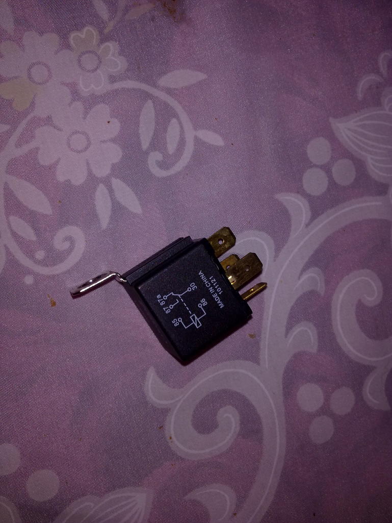

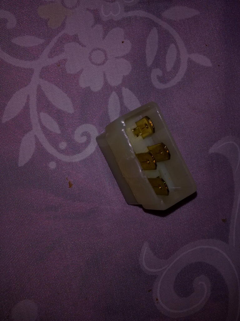

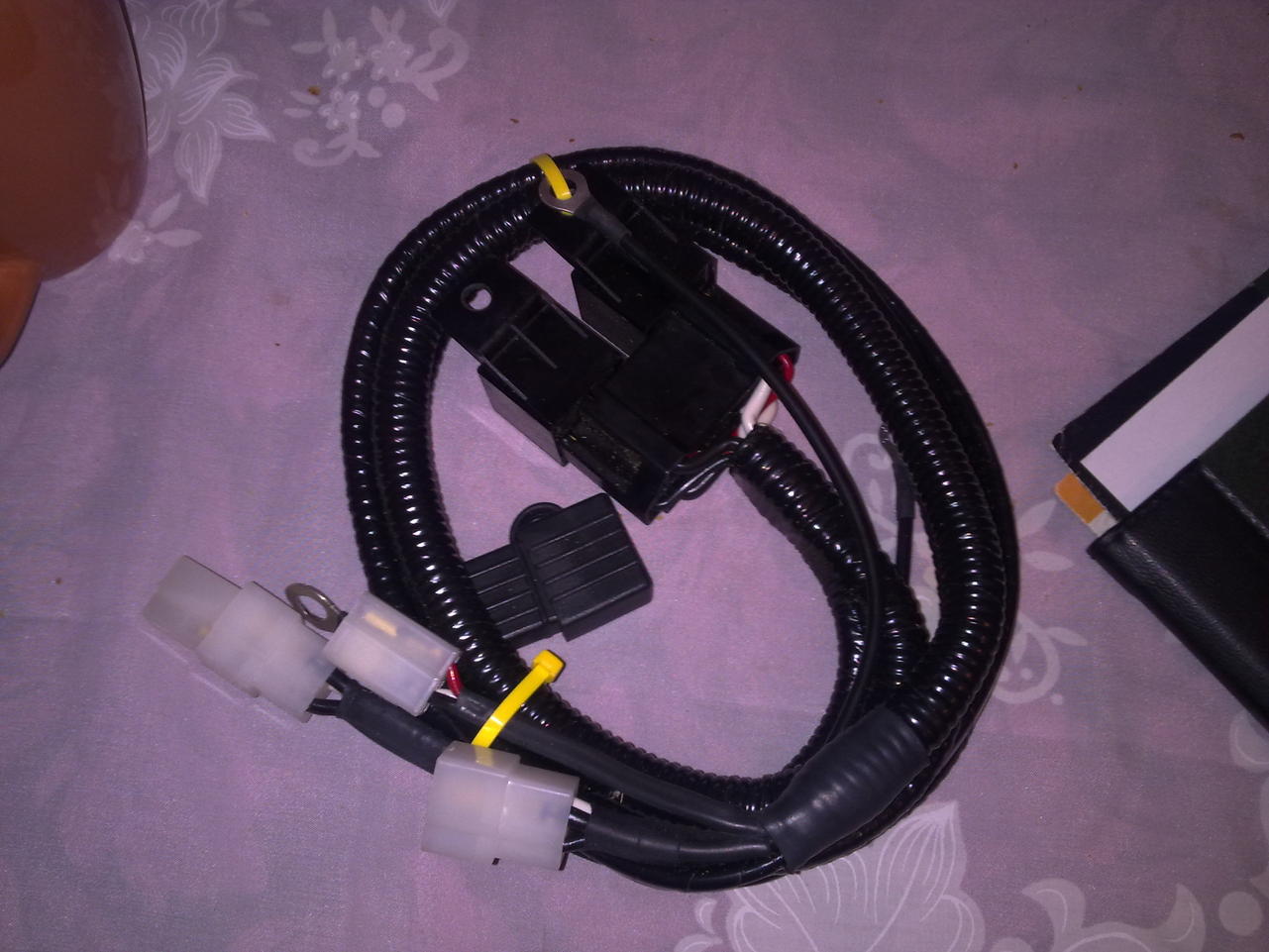

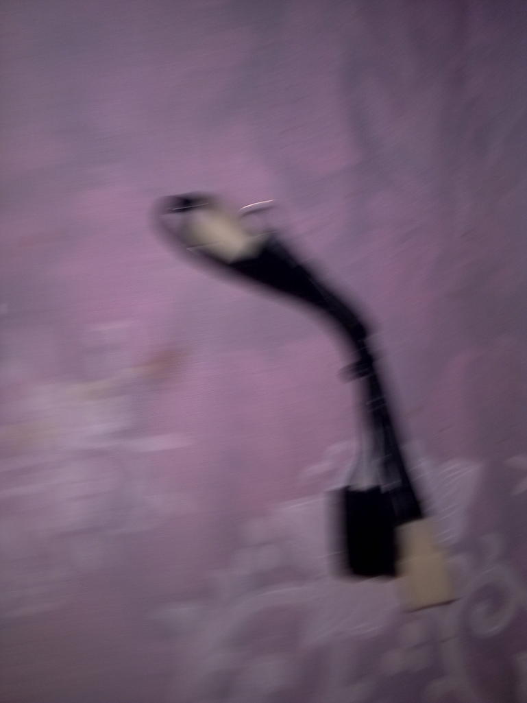

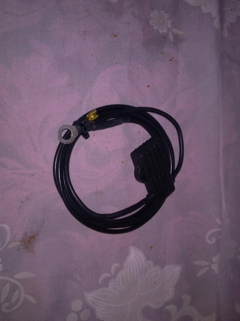

I bought a box full of parts from ebay and I found this inside. I think this is your relay kit. Can you tell me exactly whats what or if there is anything missing?
Regards,
Edited by dat260
Looks like the complete kit, headlights(pic 2), parking lights(pics 1, 3, 4) and also the diode( pic 5) for an internally regulated alternator.
The parking light relay kit, see if it's a 6 pin connector or 9 pin. 9 pin would be for a car with intermittent wipers.
There might be one piece missing, not critical. It would be for the terminal end plug for the headlight kit.
