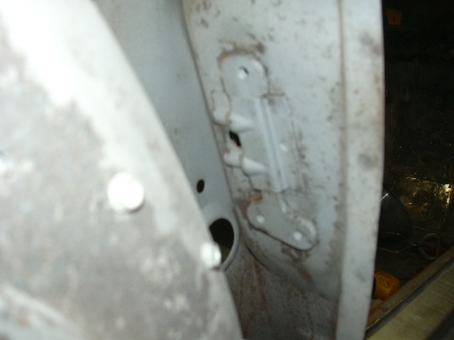

Here is a picture of the door latch adjusting plate with the quarter panel cut out.
I still believe that you can get lock nuts on those bolts after taking this picture. Will take some time and a couple of tries but, I think time still well spent.
On that captive plate, can it be easily removed once an access hole is made from behind the dogleg? Or did they spot weld that angled plate in there
so it stays in place? My top bolt on my latch stripped the other day, and I was thinking I'd weld a nut in place.
Dave
There are three spot welds that hold the bracket in place see the picture in post # 37. I don't see why you could not open up the dog leg panel tack the nut in place and weld the panel back up. You may need to replace the metal with a new piece and then refininsh the repair and put the dog leg back in place.
