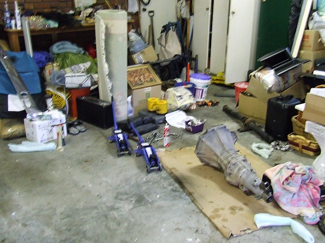

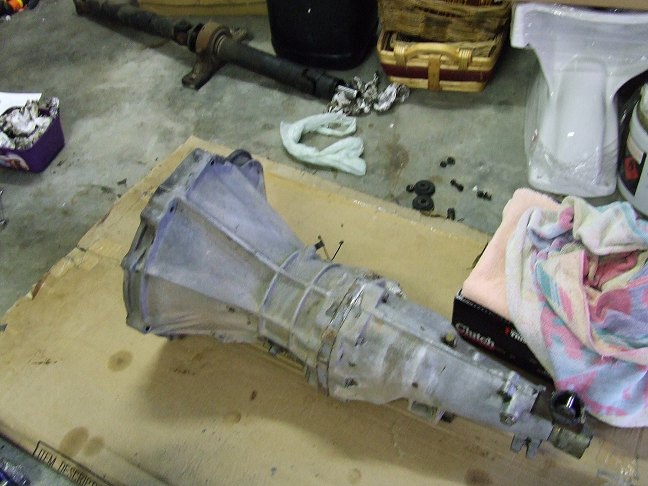

- Put a jack under the gearbox and nudge the gearbox off a bit until it's free - then slowly lower the jack at the same time as stablising the gearbox. Easier said than done!
- Gearbox was covered in oily greasy mess. It was absolutely BLACK when it came out. This is why you have degreaser, a big brush and a toothbrush!

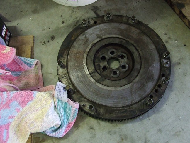

- Flywheel is to be machined during the week.
- The new clutch was not the same as the old one. We measured and it is slightly thicker as well as larger in diameter - the Repco guy is sorting it out on Monday but I think it will turn out to be a 260Z 2+2 if what Stephen said is anything to go by. We imagine this was not stock and had been replaced at some stage... so I guess if you have the choice, try not to buy your clutch before you know what size your old one is :) The new one may have fitted... but I'd rather have the beefier clutch anyway. It was then that we decided no more work could be done today.

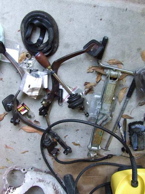

- IMPORTANT! The pedal boxes are NOT the same. There is a small L bracket that acts as a stopper for the clutch pedal, my car does not have this. Options here were to swap the whole pedal assembly or try to fab something up for the stopper. We tried to get the pedal box out of the old car but it's more trouble than it's really worth. I'm going to attempt to make a bracket during the week...
- I'm also going to restore the pedals themselves during the week.
- The circlip holding the clutch pedal on is a bitch... took a while but eventually Steve got it. I think he used needle nosed pliers?
- Going to also buy a new clutch master cylinder as the old reservoir cap didn't fit on very well... and of course you can't JUST buy the reservoir. Probably a good idea to replace it anyway, it's only $40.
- I'm also going to go to Nissan during the week to try to get a hold of some rubber boots, as the old ones were very worse for wear.

P.S. I went to Nissan to see if they had the rubber boot that goes around the metal in the centre where the gearstick comes up. They can't get one. I don't know what to do about that :/
Lachlan,
When you get the flywheel machined, have them check the balance. Sometimes, they're a bit out of balance. Also, check your engine rear crankshaft seal and replace that if necessary while the tranny is down.
Is this the one that seals to the floor? If it is, the Z one may fit. I think the holes are all about the same.
