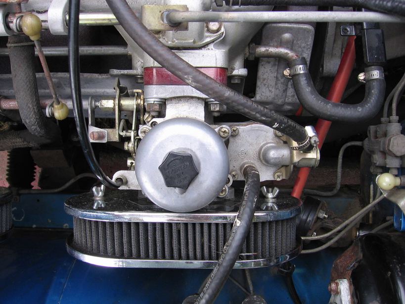

Posted January 21, 200619 yr comment_152891 The car I bought has 4-screw SU's and the '72-type intake manifold with ports for coolant to enter and exit. See thumbnails. I'm wondering if, for sure, all 4-screw SU's are earlier than the heated models. In other words, is there such a thing as a 4-screw SU with passages for the coolant. If my carbs lack those passages, is there any point at all to routing coolant into the manifold? The car might in fact run a little cooler if I simply closed off the ports--larger percentage of the total coolant then sitting in the radiator. ?? Thanks for any thoughts. Looked at ZTherapy photos but couldn't quite determine about the 4-screws. Link to comment https://www.classiczcars.com/forums/topic/18629-4-screw-sus-and-the-coolant-heated-manifold/ Share on other sites More sharing options...

January 22, 200619 yr Author comment_152945 Terrific answers from you both, many thanks for your help.I'm still having trouble determining which manifold I've got. On ZTherapy's photo, one part of the linkage (?) is marked "welded" on the 70-71. But which part? Also the "narrow pad" caption doesn't clear anything up. --Does *only* the '70-71 have the vacuum tap for the brake booster where that's shown? Because my manifold has that. You can see it at the upper right of the first photo, black hose with wire-type hoseclamp, disappearing out the right of the frame.Thanks again for the help.Steve Link to comment https://www.classiczcars.com/forums/topic/18629-4-screw-sus-and-the-coolant-heated-manifold/#findComment-152945 Share on other sites More sharing options...
January 22, 200619 yr comment_152949 From what I can see, you have the earlier manifold. Link to comment https://www.classiczcars.com/forums/topic/18629-4-screw-sus-and-the-coolant-heated-manifold/#findComment-152949 Share on other sites More sharing options...
January 22, 200619 yr comment_152952 The coolant can and will flow through the "manifold" (both halves) whether the carbs have a coolant passage or not. Look at the manifold and you will see that even the manifold at the bottom of the ZTherapy picture is set up to accept engine coolant flowing through it. Note the water fitting at the front and rear of the manifold assembly, and the water pipe connecting the two manifold castings. Also 1971 Z's (I'm not sure about 1970 Z's) had the water pipe that loops around the back of the engine and connects to the back of the manifold by way of a short hose.However the early manifold doesn't have the holes in the carb mounting surface to allow water into the carbs themselves.Prior to 72 I don't believe that there was a thermostat to control the water flow through the manifold.BTW, looking at SteveinOakland's photo's, it appears (from the brake system valve mounted on the firewall) that he has a very late 72, or 73 240Z chassis (70,71, and early 72 Z's didn't have that), but the balance tube shown is a very early one with the vac/brake booster fitting at the rear, where 72/73 (at least) Z's had balance tubes where the vac/brake booster fitting was on top of the balance tube. Also his intake manifold doesn't have the thermostat which would control water flow through the manifold which leads me to believe that his intake/balance tube is from a 70/early 71 engine.In regard to the "Welded" notation in the ZT picture, It's a pity that the picture is no longer shown with the original explanation that accompanied it when Scott Bruning (original owner of ZTherapy) posted it on the original ZTwebsite. At that time there was text which described in detail the differences in the linkage and what was welded and what wasn't welded. Link to comment https://www.classiczcars.com/forums/topic/18629-4-screw-sus-and-the-coolant-heated-manifold/#findComment-152952 Share on other sites More sharing options...

January 22, 200619 yr Author comment_152956 BTW, looking at SteveinOakland's photo's, it appears (from the brake system valve mounted on the firewall) that he has a very late 72, or 73 240Z chassis (70,71, and early 72 Z's didn't have that), but the balance tube shown is a very early one with the vac/brake booster fitting at the rear, where 72/73 (at least) Z's had balance tubes where the vac/brake booster fitting was on top of the balance tube. Also his intake manifold doesn't have the thermostat which would control water flow through the manifold which leads me to believe that his intake/balance tube is from a 70/early 71 engine.Yes, the car is a '73. It has the original engine (block) but the guy I bought it from installed the 4-screw round-top SUs and the manifold shown. From all the good stuff you guys are telling me, it's clear that he probably bought them together and just bolted the whole assembly onto the head of my car.Anyway I'm sure you guys are right that it's an early-style manifold. Also, I studied the ZTherapy photos a little further and my heat shield is clearly the earliest type.Montoyafan, this thing you describe -- "Also 1971 Z's (I'm not sure about 1970 Z's) had the water pipe that loops around the back of the engine and connects to the back of the manifold by way of a short hose" -- that's on my car. You can see the manifold connection, the hose, and the start of the water pipe that runs behind the engine, in my second photo.Thanks to all for all the help! (Looks like I leave things as-is.)Steve. Link to comment https://www.classiczcars.com/forums/topic/18629-4-screw-sus-and-the-coolant-heated-manifold/#findComment-152956 Share on other sites More sharing options...
