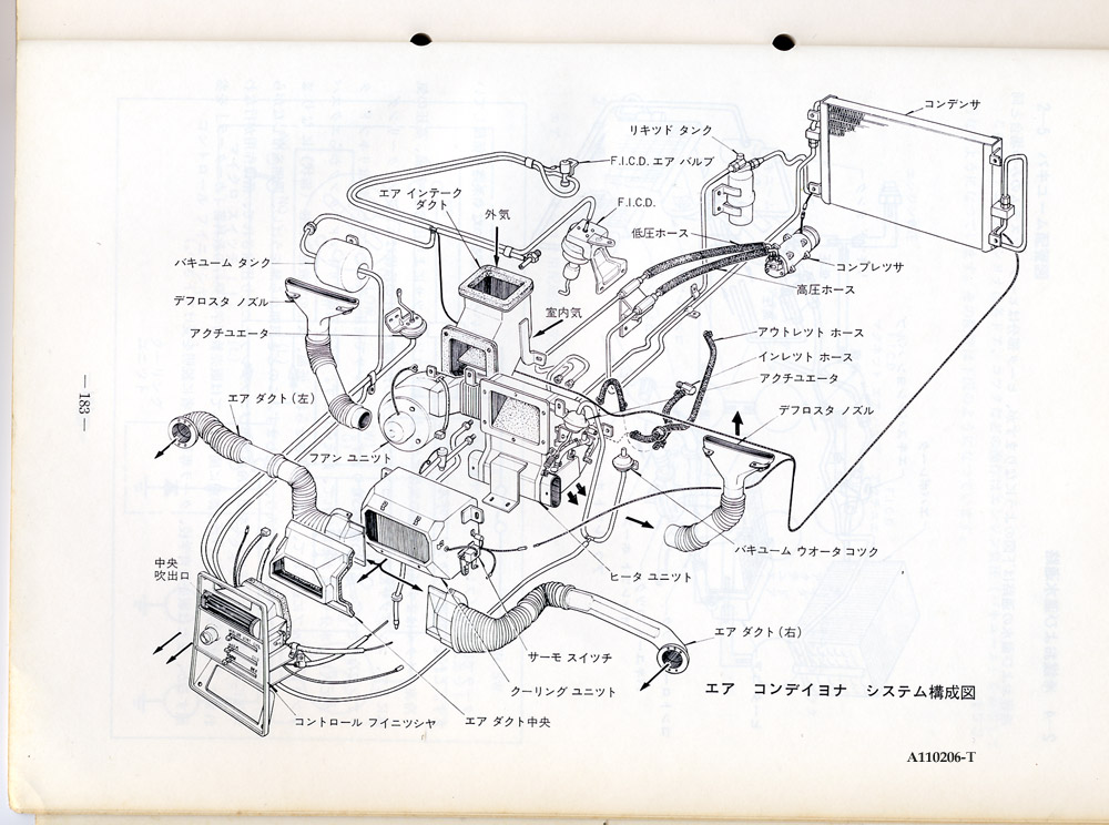

As a matter of fact, the S30 was designed to incorporate an air conditioning system. The Factory was fitting a very comprehensive system right from the beginning of sales to the general public in late 1969.
Of course this was on Japanese home-market models, and not the HLS30U.
Whether it actually worked as well as some people would have liked is another ( different ) discussion.
Another interesting discussion might be whether the original Factory air conditioning system was not offered on the HLS30U because it was designed for an RHD configuration, and only an RHD configuration - which would be interesting..........
I can't speak for the aftermarket systems on the early S30 but my 78 has an aftermarket system with a center mounted evaporator. And like the factory systems in the 74-78 S30, the blower does blow through the evaporator. I use R414B which is knows in the trade as 'Hotshot' and my system will actually reach as low as 34 degrees at the center vents. It gets pretty hot here in So Cal too and I have had no overheating problems in either of my cars. The main thing is to get rid of the upright compressor, make sure you have a good fan, make sure everything is sealed like where the evap vents into the system and where the ducts connect. I wouldn't suggest converting the old systems (factory or aftermarket) to R134A. It runs at to high a pressure and will eventually kill the system. Might not be easy for the average Joe to get some of the R12 replacements, but like I said I'm EPA certified and can buy any kind of refrigerant. Through experimentation, I've settled on Hotshot since it doesn't cause and pressure related problems and both cars have been trouble free for over three years now.
Alan, I don't see why that system wouldn't have worked on LHD cars. I doesn't appear that anything from the system is in the footwells nor would it interfere with the steering column regardless of what side it was on. It looks rather similar to the system that they started using here in 1974.

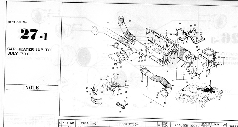

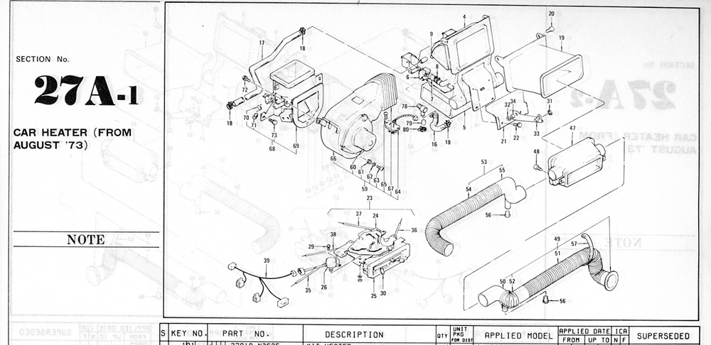

As far as I understand it ( certainly looking at the Factory parts catalogs for the LHD models ) the complete layout of the LHD heater system changed in July / August 1973.
Previous to July August 1973 the blower unit was under the RIGHT hand side of the dash on LHD models ( as opposed to the LEFT side of the dash on RHD models - as illustrated in the scan I posted ), and post July / August 1973 the blower ( and all its attachments ) moved over to the LEFT side of the dash - just like the RHD models.
Am I right?

That's not what I see in the Factory parts catalogs for the LHD models.
Look at these two scans. First is 'up to July '73', second is 'From August '73'.
Blower motor and Intake Duct etc clearly moves from the left side of the dash to the right in July / August 1973 on LHD cars.
Please tell me I'm not going nuts..........
