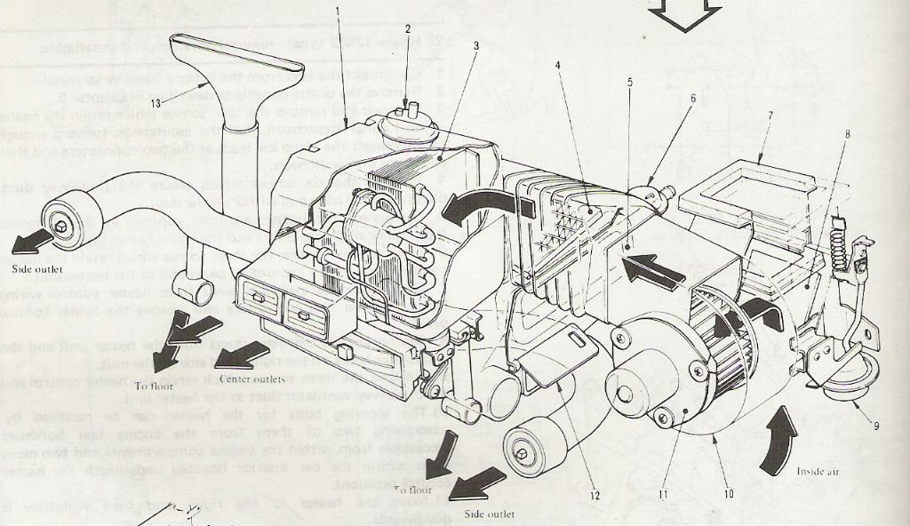

Well Alan, I don't know what to say either other than I've never seen a LHD S30 with the blower motor on the left. I must be dyselxic because I didn't notice the blower motor was on the left in your earlier scan. I was looking at the other components in the system. As far as the other scans, the one that is post July/August 73 has me confused. Here is one from one of my manuals that depicts the system in a 1974 US LHD 260Z.
Alan, I don't see why that system wouldn't have worked on LHD cars. I doesn't appear that anything from the system is in the footwells nor would it interfere with the steering column regardless of what side it was on. It looks rather similar to the system that they started using here in 1974.
Well, it looks to me as though the original Japanese market system would not be a 'bolt-in' fit to the first LHD cars. The heater casing of the pre-August 1973 LHD cars has its inlet duct on the right, the fan housing is on the right and the air intake from the cowl is also on the right. The LHD cars would therefore need their own design of air conditioning components rather than sharing the Japanese market parts.

Well, the illustrations I scanned and posted above are from the June 1974 issue Factory Parts Catalog for the 'Datsun 260Z. 240Z, model S30 series, USA & Canada' ( Nissan Pub. No. C-001OU ).
Section 27 ( 'Car Heater up to July '73' ) has 5 pages of illustrations showing the inlet duct and fan housing on the right.
Section 27A ( 'Car Heater from August '73 ) has 7 pages showing the inlet duct and fan housing on the left.
The same manual also has the ( new for August '73 ) Air Conditioner system illustrations in Section 29 ( three pages on the interior components ) and these all show the inlet duct and fan housing on the right........
Does this mean that the illustrations in Section 27A are actually wrong?
I mentioned it because I thought it might be significant. I saw the illustrations showing the - apparent - movement of the air duct and fan housing right at the date the Factory air con system was phased in on the LHD models.
All of this would be easy to put to rest straight away if the illustrations in section 27A of the parts catalog are incorrect. I've seen a few little mistakes in other Nissan parts catalogs and workshop manuals for the S30-series Z, but this one is a biggie and I've never seen any reference to it.
