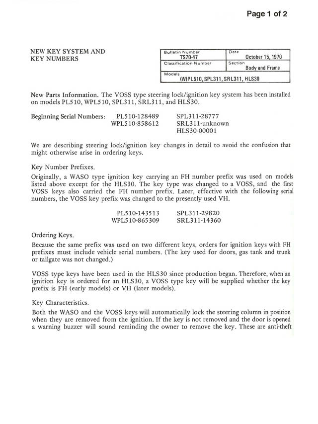

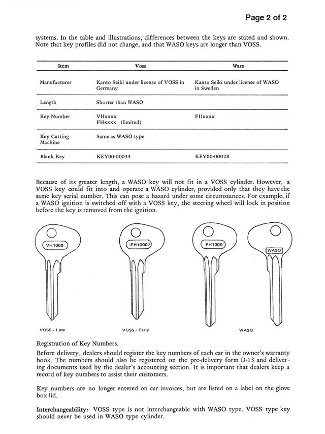

Hi Guys:
Here is a little additional data, for the owners of Series I Datsun 240-Z's in North American Market Spec.... but might also apply to the HS30's in Australia/NZ and other places.
Technical Service Bulletin TS70-47 New Key System and Key Numbers:
see attached:

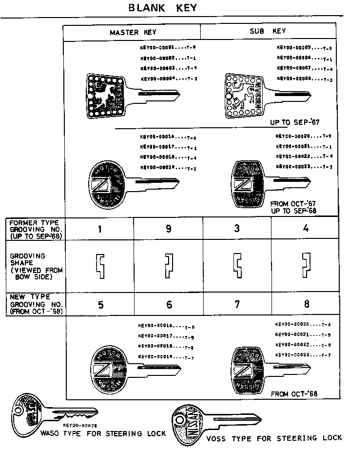

Hmmmm,
I don't know, ..... I guess it depends on how you look at it.
Stand the key up vertical, (on it's pointy end), .... it's a "N". :cry:
Horizontal, ....... it's a "Z". :D
When you think about it, does a key go into a lock in the vertical or horizontal position ???????????????LOL

Got it. This scan shows a similarly marked key and indicates its use from early as October 67; way before the Z was built.
Id have to say it was an "N" for Nissan based on this.
Anyone know where or why Datsun used the Griffon on the keys shown prior to Oct. 67? I've never found any reference to it in any Datsun/Nissan documents nor history.
