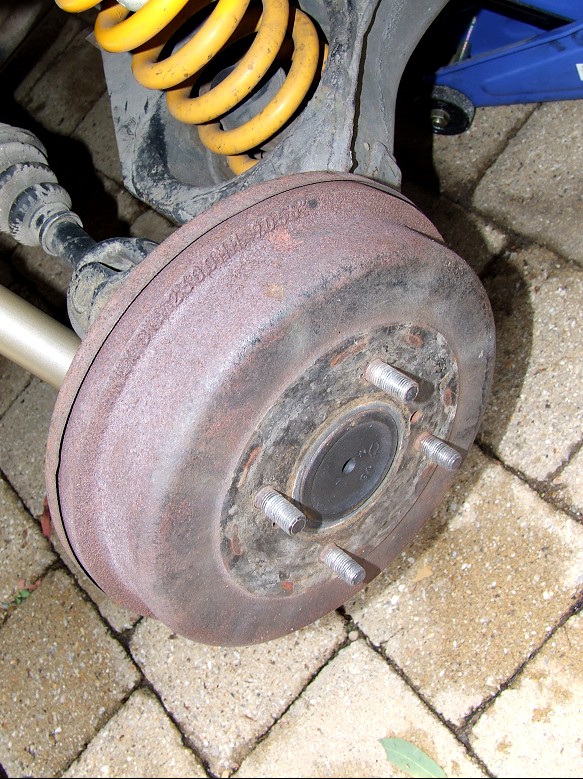

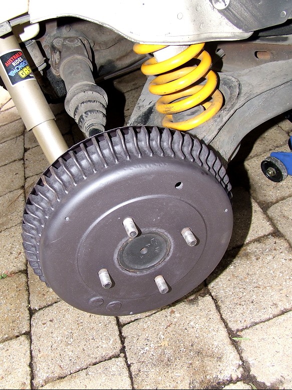

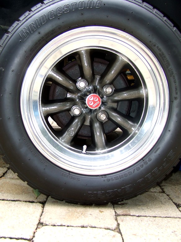

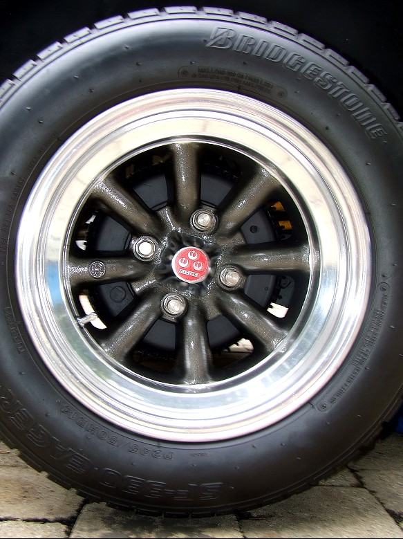

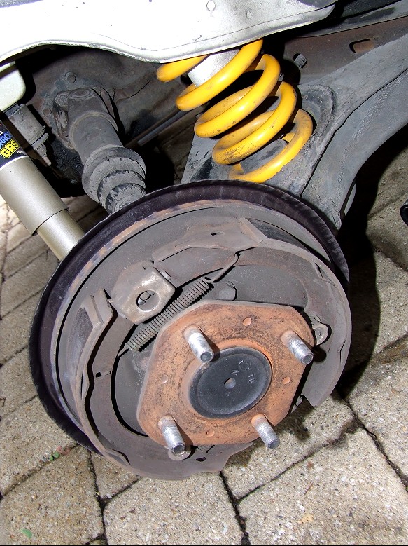

1. Appearance with stock drums
2. Stock setup
3. Backing plate bent back, sanded and painted
4. S30 finned drums on
5. Appearance with S30 finned drums

If you've properly bled the brakes, then your back drum shoes probably need adjustment (the new drums may be slightly more worn than the old ones). The back brakes aren't self adjusting, so no matter how much you bleed the brakes, they will always feel spongy.
You'll see the adjuster in your picture where the drum is off, at the top of the assembly, where the tops of the brake shoes pivot. This has bolt coming from the back, which has a tapered head on it (between the 2 pistons that locate the upper ends of the brake shoes). This can be screwed in or out to adjust the brake shoes (although it's best to remove all load from it before trying to adjust it, as it will probably be very tight and rusty).
