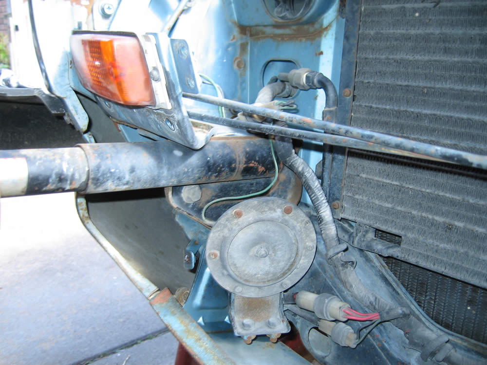

Now I want to fabricate an mount for the Z to which I can mount the tow bar to. My idea was use the existing holes for the front bumper attachments and mount it from there. When the car is complete I only need to take off the horns, front grill and maybe the lights to get access to them.
My other area I have thought was the front tie down hook area, but to make that work after I have my front air dam on my Z won't happen to easy. So I think it's the front bumper mounts.
I have also thought about just bolting an attachment to the front bumper mounts like the existing bumper, but I don't think they were durable enough for towing. If someone know's otherwise let me know.
I have attached a photo of the front bumper mounts for referance of where I want to make my attachemtn.

Gregg - Many moons ago ('81) my brother and I towed his '71 back from Vancouver with a homemade tow bar. The tow bar was bolted to the bumper mount points (ie -remove your bumper shocks in the picture and bolt the tow bar there). Remember to allow the tow bar to pivot otherwise you'll torque the front-end... And use safety chains...at both ends.

Cool, glad to hear someone else has done this. The towing unit won't be a direct link to the ball, but use a univeral towing bar attached to a homemade "bumper" that is attached using the bumper shock holes. I figure this will be the best way to go.

I have one on my 71 240Z. Its permently bolted to the bottom of the radiator core support. There are 2 bar attachment points just below the front valance. My experience in towing Z's with this setup is that they don't tow well at all with out a engine in them. If the z is complete they tow well.
