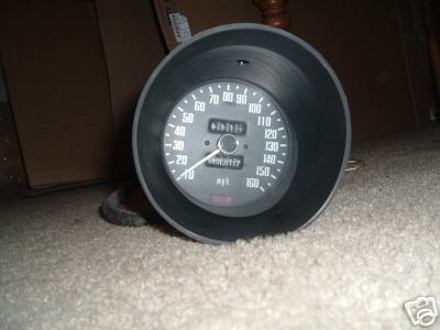

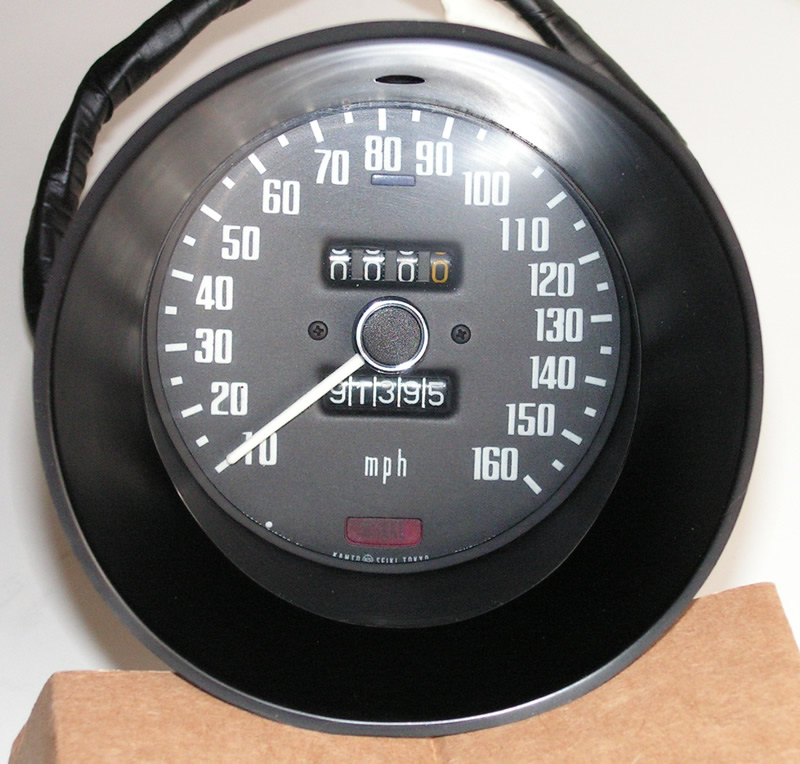

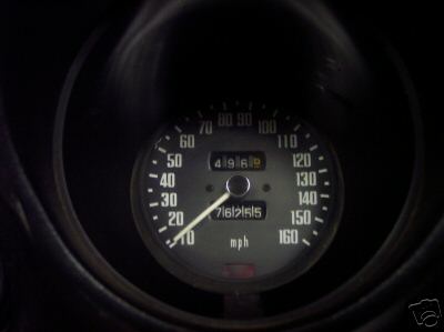

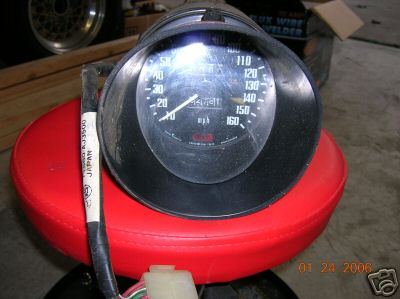

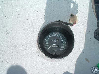

What years came with the speedo that starts at 10MPH?
Did some poking around on eBay. The links below plus Stephen's post above added to my knowledge of my personal car now lead me to believe that:
'69 through early '71 (Series I cars) started at 20.
Late '71 (Series II) and '72 cars started at 0. (Edit - added info from posts #9 & #10 below.)
'73 240s and all 260/280s started at 10.
Added pictures to the thread, will try to remember to complete the collection later. Filename indicates the year.
