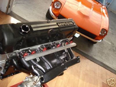

According to a heated discussion going on in a thread about someones 240K, one of the members there states that there was a L6 DATSUN OHC valve cover:
Part number 13264-E3100 is a DATSUN cam cover for an L24. Part number 13264-P0100 is a NISSAN cam cover for an L24 or L26. At least that was what they were when I had to replace a cover back in '72 after a cam gear bolt came loose (and initially got the wrong, E3100, cover).
Can anybody verify this via the parts cd, or microfiche etc?
  • 6 months later...
I saw a JDM (aftermarket I think) cover with the Large block lettered NISSAN. But this cover was plastic. Les Cannaday had it in his shop and was very excited over it. As to why he was so jazzed, I didn't catch the story.
Was the plastic valve cover like this one Victor?
http://cgi.ebay.com/ebaymotors/Datsun-240Z-260Z-280Z-ZX-JDM-Valve-Cover-NR_W0QQitemZ250057883925QQihZ015QQcategoryZ33627QQrdZ1QQcmdZViewItem
Is there any advantage to getting one of those for a L24 block, or is that something mainly just for looks?
