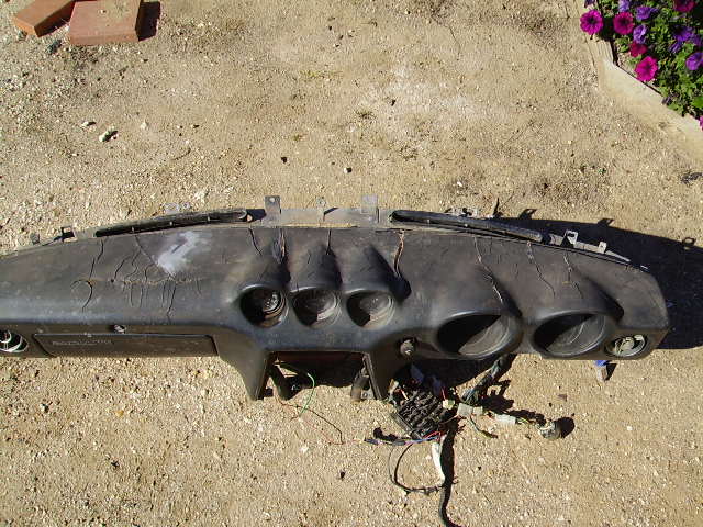

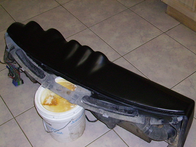

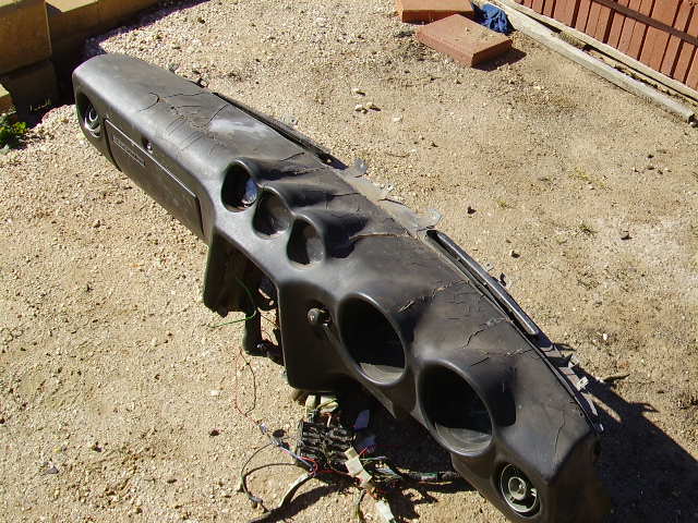

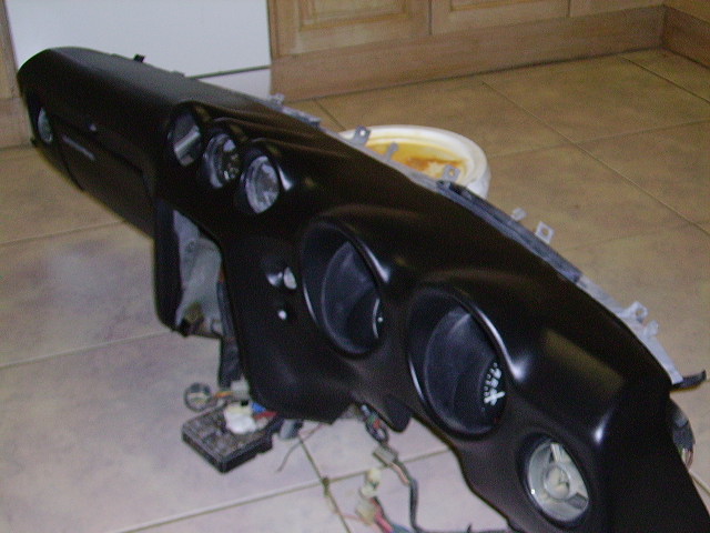

All done, dash removal was pretty easy I didn't mark the connectors as most are one fit only, pulled the fuse box with it.
I've restored the dash and really happy with the result, lifted the interior by 200%. All up the cost of materials was $70, in the end I needed two tubes of flexible filler, it was that bad. Check out the before and after.
I contact adhesive the lifted parts of the pad to the frame, v groved all the cracks with a flap disc on an angle grinder and in the end took most of the brittle vinyl off the top.
Filled the cracks and top with flexible plastic bumper bar filler,sanded and resculptured the pad, wipe down with prep wash, spray canned with K&H flex primer then sprayed black K&H textured flexible bumper bar paint to finish.
Adjusting air pressure I was able to get the right ripple and texture.
Everyone thats seen the dash has been impressed, just a shame I'm now going to cover my handy work with a dash mat!
