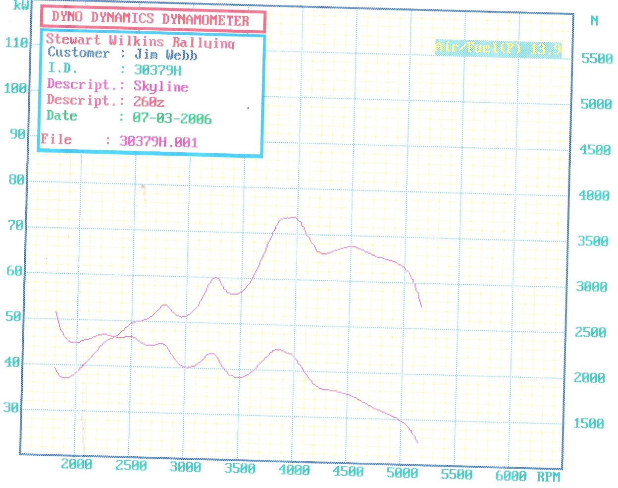

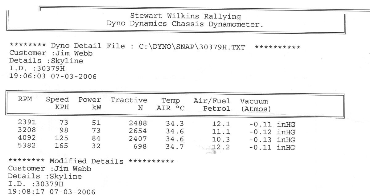

So anyway the guys run it up on the dyno a few times, 6000rpm limit. Sounds OK at first, but as the revs climb I detect "fluttering" on and off...revs still going up, now definitely running on 5, maybe even 4!! Sound like it's revving it's tits off and getting nowhere.
Have a look at the printouts, ever seen anything as crook as this:disappoin
I had a chat to the guys running the dyno, they certainly know their stuff, and seemed sure a lot more could be coaxed out of it when the obvious problem (cause yet unknown) is addressed, but with everything considered felt it wasn't major. Noted was the air/fuel figures were running at turbo type ratio (thick and rich!) I am going back to them and booking it in for a diagnostic and fix soon.
For all you guys that have played with these engines and had to interpret readouts,what's your take on what you see? Any experiences in using a dyno as a diagnostic tool? I realise guesstimates are the best you can hope for when considering a picture, but I would be interested on any and all takes on what you see. All constructive suggestions, thoughts and comments accepted gratefully. Anything else....well I got a pretty good sense of humour, Geez ya gotta have, eh!?:classic:

If Stewart Wilkins is as good as he says he is he should have it fixed in no time. From the sound of it I think the problem would be a distributor related issue. I would check the breaker plate if it's the E12-80 module electronic distributor. It just won't let the engine advance and caused me all sorts of grief.
Seems like the old girl should be putting out more power. However if it's only had a mild port and mild cam then I guess it's probably correct.
SWR does fantastic work.
They get the job done even if it means thinking outside the box.
Just as an aside, they had my L6 on the dyno and my initial tune looked very similar to yours.
A few hours of tuning changed the figures from 60kw@the wheels to 120kw@the wheels.
I wouldnt be surprised if you could get something significantly over this figure once your engine is fully sorted, seeing as you have more 'fruit' than I.
Are they happy to play around with the Mikuni's?

Hey Vincent, Good to hear from you.Where ya been? thanks for the input, that is most interesting!!. Regarding the Mikunis, the guys didn't seem fazed at all...comfortingly confident in fact. A bonus is I'm 5-10 mins from their shop!
Now your chart is more what I had expected or hoped for. Mine may yet turn out to be a lower powered package than anticipated, but to be honest what's there now is really a buzz to drive! At the risk of falling into the same trap twice,( getting all starry-eyed over what I am told) I have another triple 45 webered L6, once again an unconfirmed package, but it is rebuilt and unused, the builder garuanteed the original owner ~ 280 reliable HP, and was known for his high HP L6's. Trouble is it sat unused (well protected) for 16 years, the builder has retired to the tropics and everything about it is subject to the memories of two chaps in their late sixties. It will be torn down and inspected in time.They thought it was fitted with an option "1" box. Once that was proven wrong he remembered " Ooh yeah, that was too expensive so we got a ZX turbo box to handle the power!" well that appears to be wrong also, although it may well be a 280ZX box. This is certainly not a gripe as I was practically given the whole lot.

Hi all I have 5 c worth for you on those 6000 rpm fading ignitions. my experience caused me some heart-ache on the way to Melbourne I had the MITSU distributor, and it would break down in the 5500-6000 range. I was sourced the Hitachi ran better but not everything I expected. inspection and rebuild cured the Hitachi, I stored the MITSU after its rebuild had no call to re install it. major problem with both seemed to be a sticking plate and a little shaft end play.
Also interested in that story about the two men over sixty who built that engine all those years ago, I am sure I know them, I think they built my L6, it is still going strong. Can you do an inspection of the internals without doing the tare down, it may be good if the oil was sprayed in the right way. A priming of the oil system and a bore soak may save a lot of effort.

Thanks for all the replys so far (hint hint!) guys. It would appear the dizzy is definitely one of the contributing culprits. Just on that area, whats the considered opinion of the distributor running with the Vacuum advance disabled? . Is this a consideration to the lack of steady constant vacuum at relatively low engine speeds/loads in an engine fitted with a combination of a large or many carbys and a cam with a big overlap? (not gospel, just my wondering)
