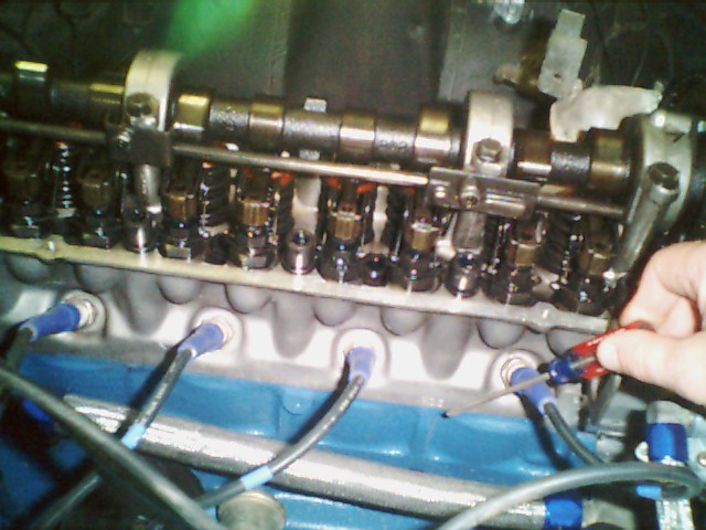

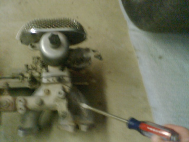

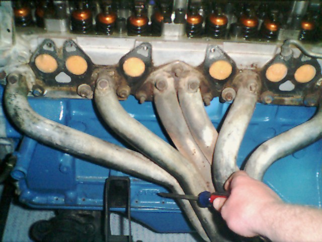

I'm not quite sure what head I have..Sould i be looking on the manifold, which has E88 stamped on it or what. It appears to be an N42, because that it what is stamped on the passenger's side of the block or is that the type of block I have..? I think what is confusing me is that I appear to have an N42 block and an N42 head is that possible? I don't know because I'm not sure where to check for each stamp (Head, manifold,and block)..
