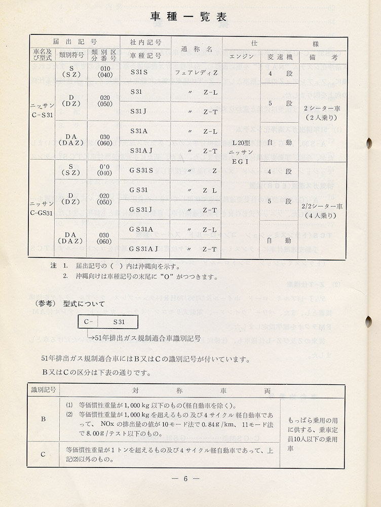

The 'C' prefix denotes models that were fitted with extra anti-pollution equipment, in order to be compliant with the stricter regulations phased in during 1976 ( Showa 51 ) in Japan.
Here's a scan of the Nissan 'Service Shuho' manual which covers those models, with a page that explains the model breakdown and the anti-pollution compliance specs:

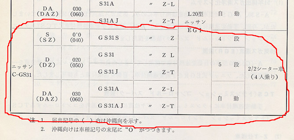

If there's anything you don't understand about the model chart I posted, just ask. I think its actually more simple than you think.
See the file attached below for explanation:
Looking at the rows from left to right, your car is a '2by2' - so you can ignore the 'C-S31' 2-seater rows and just focus on the 'C-GS31' rows below it.
If your car didn't come with a four-speed transmission from the factory, you can be fairly sure that it probably wasn't a 'GS31S' base-level 'Fairlady Z' model ( although somebody might have specified the four-speed as an option ). So you can now focus on the four remaining types: 'GS31', 'GS31J', 'GS31A' and 'GS31AJ'.
If your car doesn't have an automatic transmission, you can forget about the 'GS31A' and the 'GS31AJ'.
Which leaves you with the possibility that your car is either a 'GS31' Fairlady Z-L or a 'GS31J' Fairlady Z-T. The main difference is in the trim levels - the 'Z-T' was a higher spec than the 'Z-L'. If you have electric mirrors then it is quite possible that it is a 'Z-T'.
