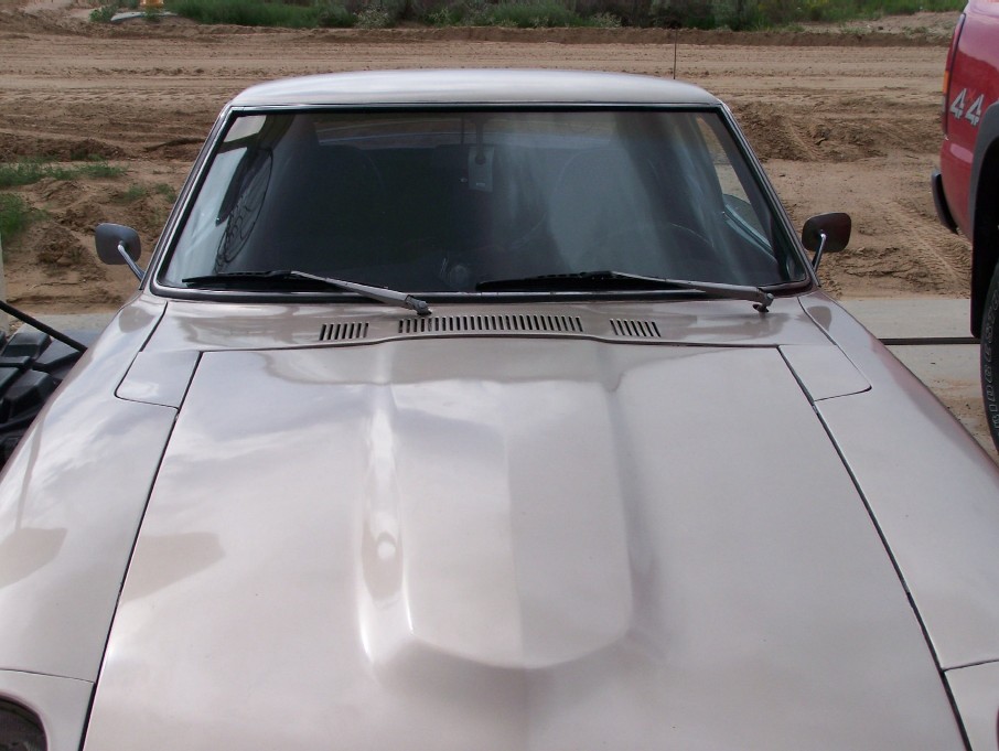

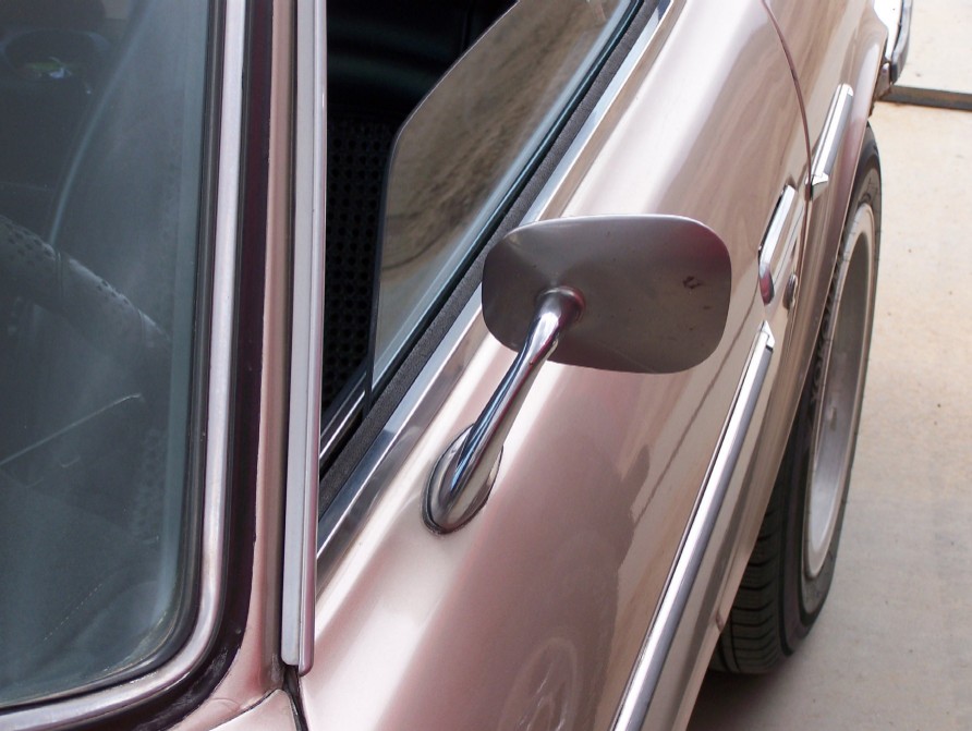

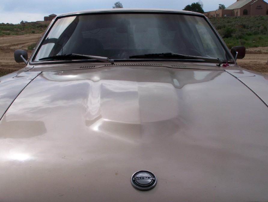

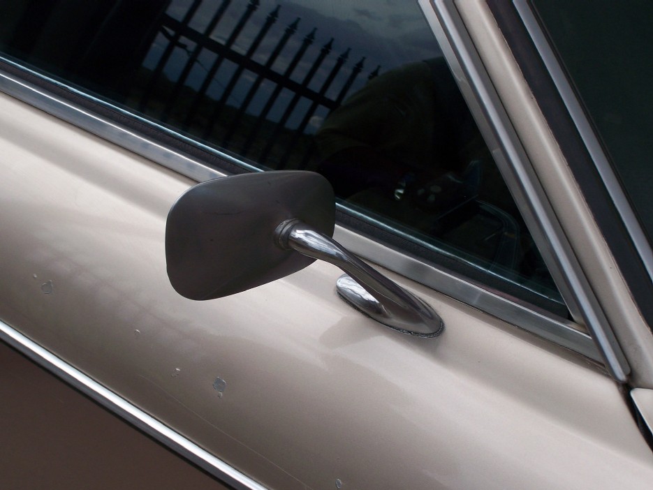

JFYI - My current 71, manufacture 2/71, has the round chrome coat hangers. My first '71 (5/71) had the black plastic coat hangers and both have/had the lighter on the left. Neither have/had screws in the door panels. One thing I have never seen until my current Z is a passenger side rearview door mirror that matches the factory drivers side mirror. -BJ-
Would you mind posting pictures of your mirrors, more often than not(ALWAYS) the matching mirrors have turned out to be the same mirror with the flag rotated. The passenger side mirror is really a manipulated drivers side mirror.
I have looked and conversed with everyone at Nissan USA that would return a phone call, letter, fax. or a shout in the parking lot, and never found even a part number for one-unless you aren't talking aout the ones on this and many other threads I have jumped into:
http://www.classiczcars.com/forums/showthread.php?t=17716&highlight=usa+members
Thanks,
Will
Here are photos of the mirrors on my car. I haven't found part numbers either in my searches. -BJ-
Notice the differing angle of the main stalk from side to side. I believe that the one on the right side is a left side mirror with the mirror head swiveled around.
