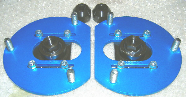

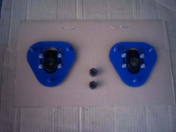

Can anyone tell me the difference between
http://page3.auctions.yahoo.co.jp/jp/auction/c108361236
and
http://page13.auctions.yahoo.co.jp/jp/auction/r24545868
And secondly, would it be possible to get something like this in Australia for around the same price? Where might I look??

Hi Lachlan,
i have my camber plates with the car, so i will get you a photo of them on the weekend, from memory though they are similar to the 1st photo. Let me confirm that for you.
I am yet to put them on yet though, so not sure how well they fit, but they are designed for teh C110 so they shouldn't be a problem.
I looked around OZ for a set, but the only ones i could find were uber expensive (around $400) and they were universal type ones.. definately better getting them out of japan!

Hope you are not planning on any rough roads 'cause these style camber plates tend to slip when jarred hard!
I've gone the other way with slots, reinforcing plates and cam adjustment discs on the inner end of the lower arms.
That's never ever been a problem on my car, and I've never ever heard any of the racers that I know complain that a camber plate moved. I have however heard of cam style adjusters moving, particularly the G Machine style for the 240Z rear suspension. Many racers use set screws to prevent them from twisting, as the clamps that hold the bushings apparently aren't enough. If you think about it, the control arm puts a hell of a lot of force directly on that eccentric when you're cornering at 1g for instance. How much of that lateral force is put into the camber plate, which is insulated by the spring and shock, and not directly in line?
Japan Yahoo ads usually say that they fit C10 and C110, and sometimes S30 as well. eBay sellers say 510 and Z. Maybe they fit all the bigger Nissan cars of the era. Mass-production parts bin saves money. Gotta do some research in the parts manuals . . . . .
510's usually have a larger plate because they have more room in the top of the strut tower to adjust. The 240 has a relatively tiny tower and so needs a much smaller plate to fit in there.
