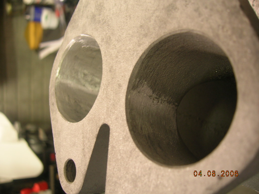

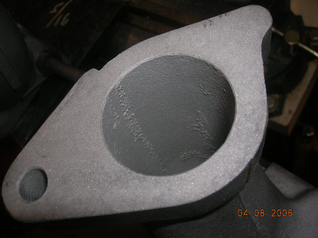

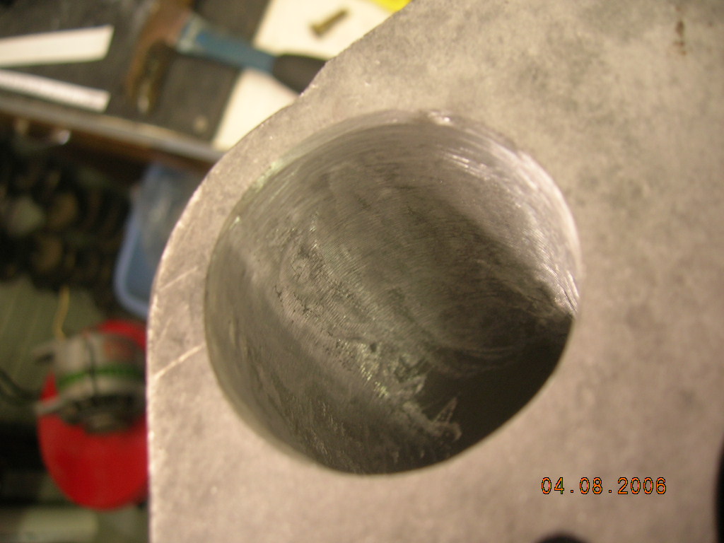

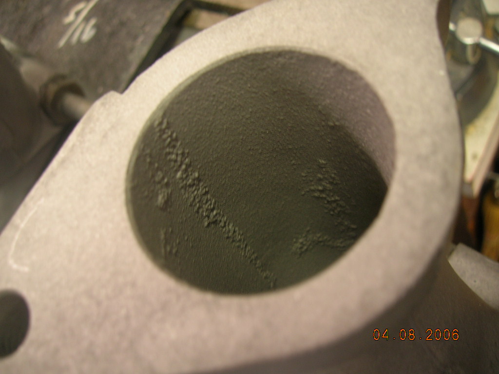

So I bought a set of N36 manifolds on eBay and decided, what the heck, I'll be my own guinea pig. I made a jig to mount the manifolds and I'm doing some mild porting to get rid of the parting line roughness. Its amazing how rough they actually are.
I've read as much on the subject as I want and I know some will say the manifolds need a little roughness to keep the fuel in suspension. Okay has anybody looked in a new Edelbrock V8 aluminum intake lately? Amazingly smooth. All the way from carb flange to head flange. So what I'm doing should give me something. Remains to be seen whether its good or bad. If its bad, I'll just put the stockers back on and no harm done.

Well , for one thing as soon as you modify the #36 manifold any numbers you get testing on a dyno will mean nothing . If you want to test for effectiveness . First run the stock manifold then the 36 unaltered then do all the grinding you want and test again. The numbers will then show the differences. Comparing a large V-8 to these little 6s is comparing apples to watermelons . Every engine builder for performance that I have talked with about these in line engines has said just what you alluded to . The roughness in the intake is left for a purpose , to cause turbulence and to keep the fuel mixture from condensing on the walls of the manifold . Smoothing out the exhaust manifold is a different matter . Now matching the size of the intake and exhaust ports to the openings on the head and sizing the gasket also should be done . This information that a 10 HP gain has been kicked around for years and years . I have never seen or heard of anyone actually proving this on a dyno . Seat of the pants results mean nothing to me . Phred who is a member here may have some input on this as he builds these engines . Kim Blough is another . Gary :)

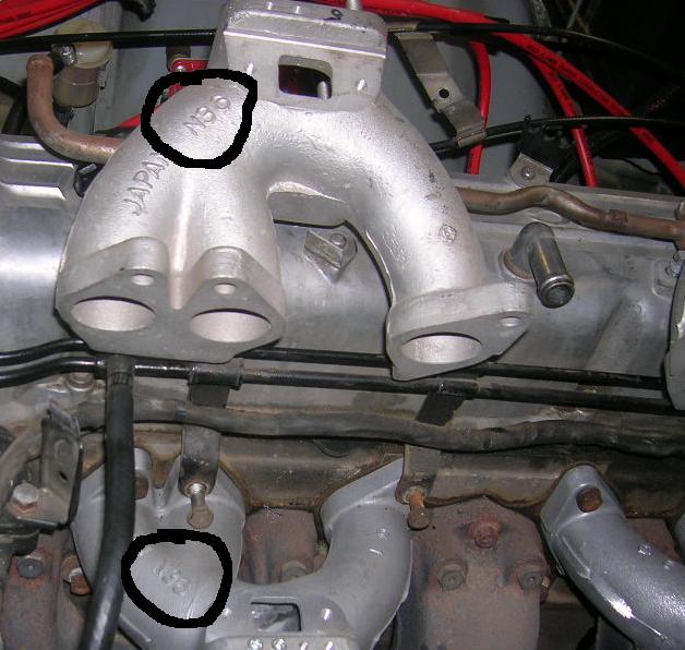

Hi Steve,
If having problems finding the N-36 manifolds, give a N33 a gander....came on the 73 240Zs, other then the number cast, on top, look identical. From memory the casting number on bottom side is the same as well.

Testing the polished intakes could distort results somewhat. If interested, I'd be happy to send you a untouched N-36/33 to test along side your other intakes...

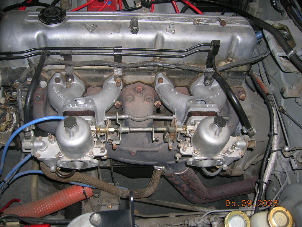

Hello all,
Thanks for the feedback so far.

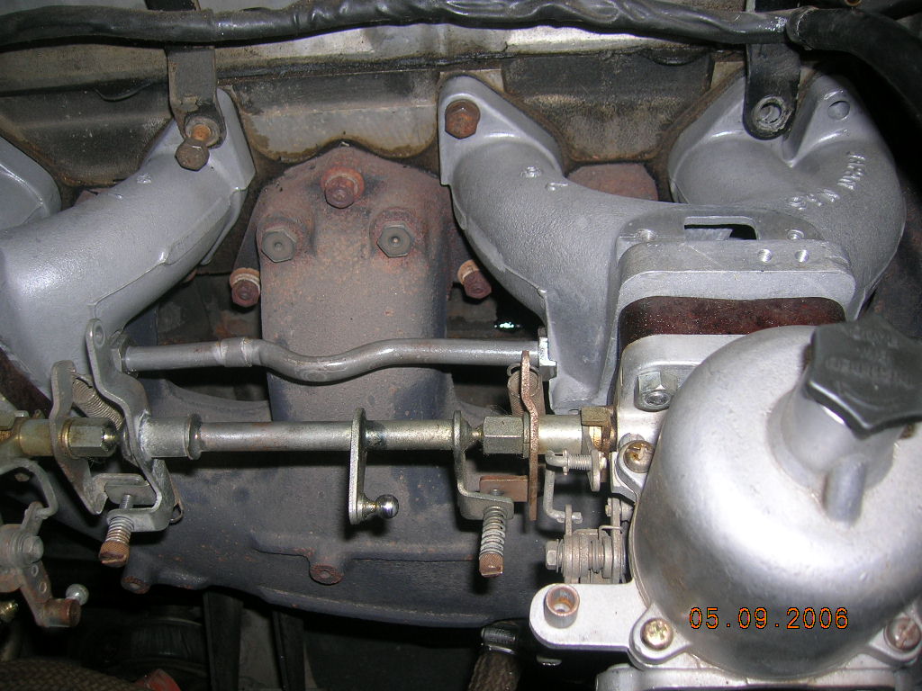

Tonight I removed everything from the head. I decided to do a trial fit and make sure everything would go smoothly. So far so good. Carbs/linkage/balance tube all fit the N36 manifolds like they were meant to be there.
I thought I had a pretty tidy engine bay till I got all the stuff off. A good cleaning is in order after its back together.
I took David's (dspillman) advice and will dyno a set that I did NO porting on and then will dyno the ported set. Three dyno runs ought to prove one way or the other.

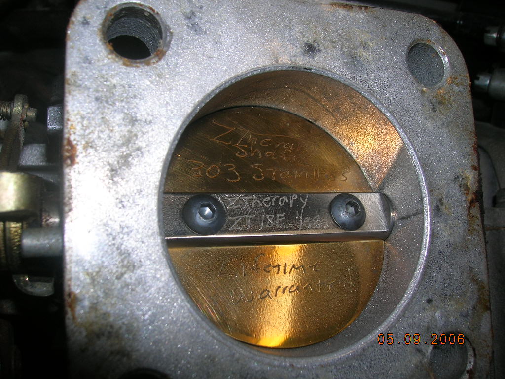

I've attached some more pics. I shot a close up of the butterfly on my ZT carbs I got in 1998.
Chris

Well, the tweaked N36's are on the car. I've driven it on the street three times. Seat of the pants (which means nothing to some) reaction is that there is no difference till 2500 to 3000 RPM. Then the motor seems to come to life. There is no dyno that I can find in Lincoln. I have to go to Omaha. And right now, I'm still getting the bone stock set of N36's ready so I can do a stock versus tweaked comparison. It'll happen though, eventually.
Car is not going anywhere right now as I'm replacing the rear struts.
Anyway, if your motor is bone stock, this modification will do nothing for you. Mine is not stock.
