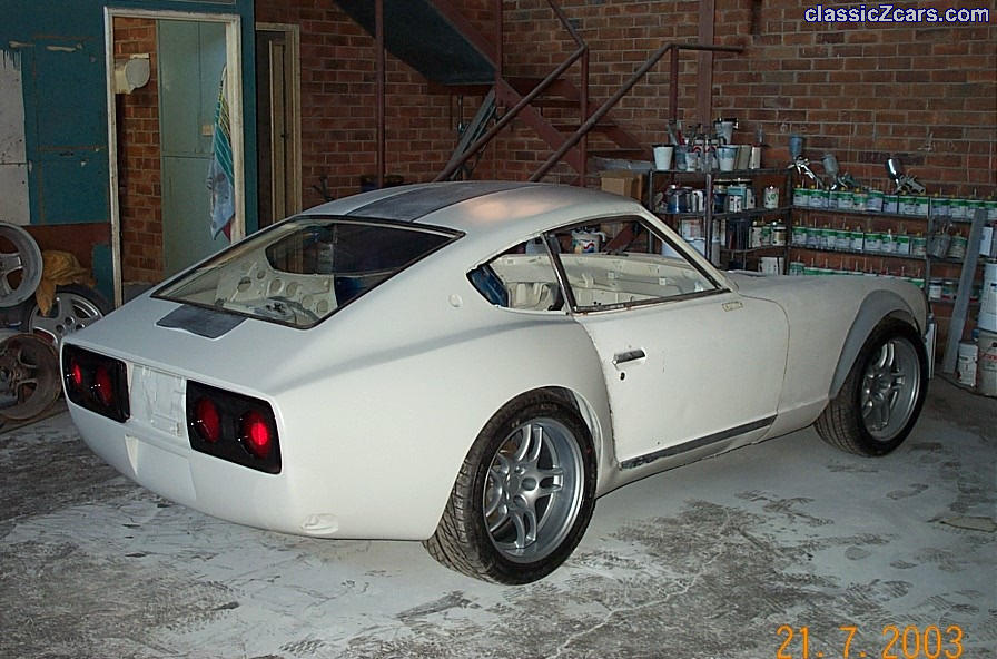

Finally, after so long I decided to pull my finger out & give my thumb ago... so I got stuck into the doors. The door shells were perfect, just surface rust but the skins needed changing (dented & rusty).
The door shells were garnet blasted then sprayed with POR 15 followed by fabricating new double intrusion bars made from T6061 alloy. These are much stronger than the single flimsy original pressed steel type.
There has also been a change to the door handles, out with the old & in with the new... now sporting the R32 Skyline type.

Me too but life happens, family, divorce, health issues etc but after spinal surgery I'm slowly getting back into it again,
but there's been a big changes since... it's out with the SR20DET & in with a V8, along with swede dash/interior & custom rear hatch glass.
