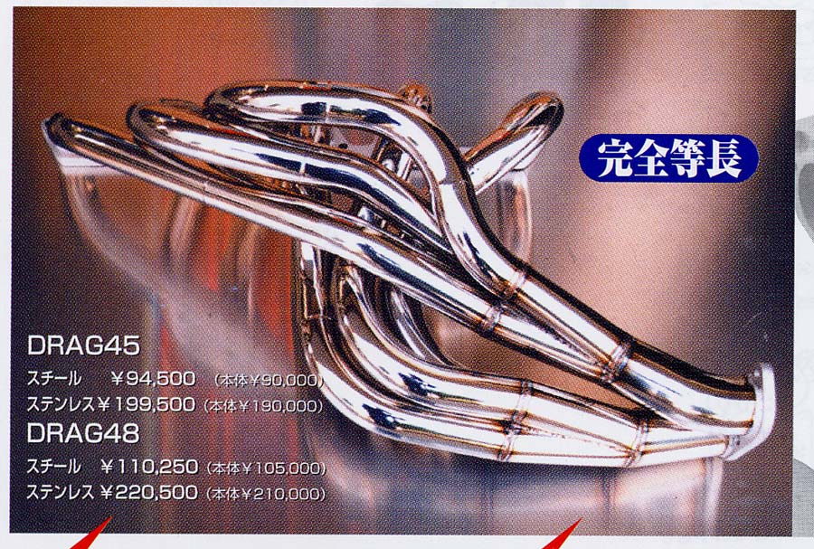

In the meantime, how about a Kameari Engine Works 'DRAG 6-1' 48mm unit at 294,000 Yen?:
Alan,
6 into 1? I've never seen such a thing until now. Price seems about right, though.
Don't forget the "waiting period" of 45-60 days while they fab the unit from scratch because it's not a stock item.
Wow that's enough money to put a big hole in my wallet. It sure is pretty but I don't think it's worth that much to me.

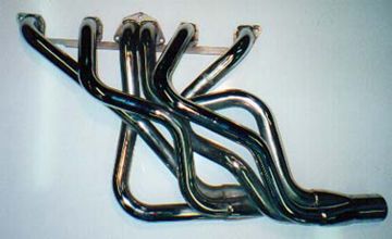

I'm wondering what the general consensus is on this piece http://www.rebelloracing.com/price_zheader.jpg
I believe it's a Nissan Motorsports piece and is the same as on the cover of Frank Honsowertz book the "how to modify....."
It obviously works for Rebello.

The drag header you posted is very interesting.
"In the meantime, how about a Kameari Engine Works 'DRAG 6-1' 48mm unit at 294,000 Yen?:"
Question?: I assume the 48mm is the primary diameter, and assuming the exhaust pulses overlap (volume of six primaries full 50% of the time) then the tail pipe would have to be 83 mm (3.27 in) diameter. If no overlap than 117mm (4.63 in) diameter!!!!! No wonder they are listed as "DRAG" headers, tough to fit that size of pipe under a road racer!
Any additional spec's regarding final tail pipe diameter listed in your info on those beautiful beasts?
I'm afraid I don't have the kind of detailed data that you are asking for, but I'm sure that Kameari have got all kinds of graphs, readouts and technical specifications for them. They are very thorough, and they are very serious about what they sell.
Obviously this manifold is Stainless steel, and Kameari say that it is a "true" equal-length design. Pipe length is quoted at 800mm ( they don't give the size of the final pipe joint diameter ) and of course I think it goes without saying that LHD fitment will probably be a no-no due to its sheer bulk.
Only other thing mentioned in the sales blurb is that this header is definitely drag-oriented ( mid range to high rpm bias ) and probably not very suited to street cars, to say the least.
Kameari have some other ( more sensible ) designs in both Stainless and mild steel - in sizes of 45 & 48mm. See attached pic:

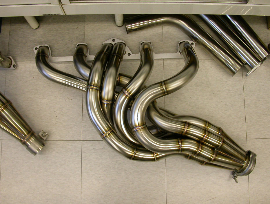

Ron's headers are very unique. I would guess that $500 would probably get you 2 of the 6 tubes (am I about right Ron?).
