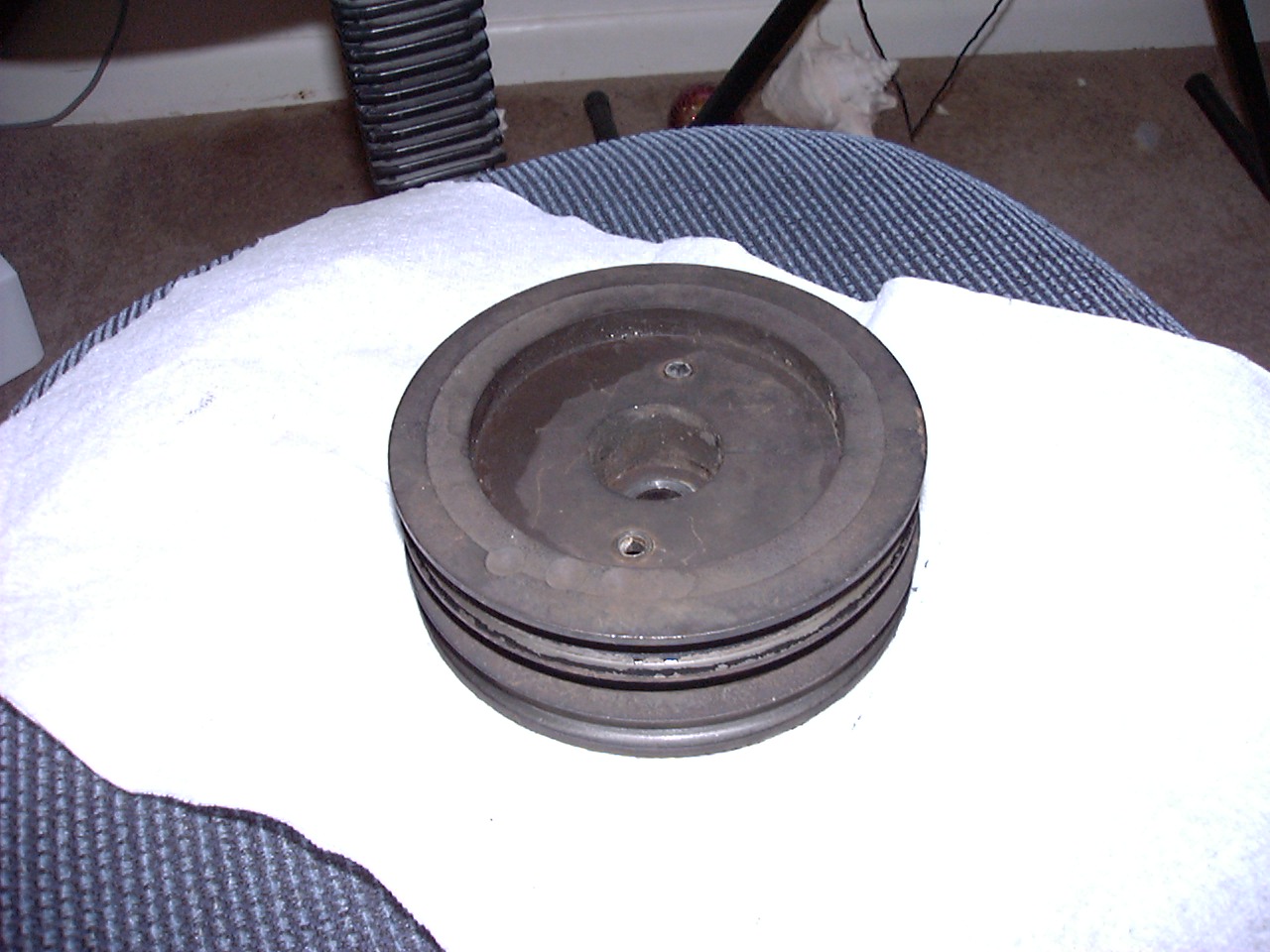

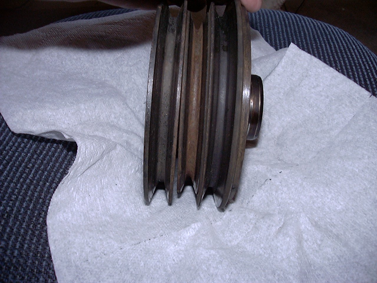

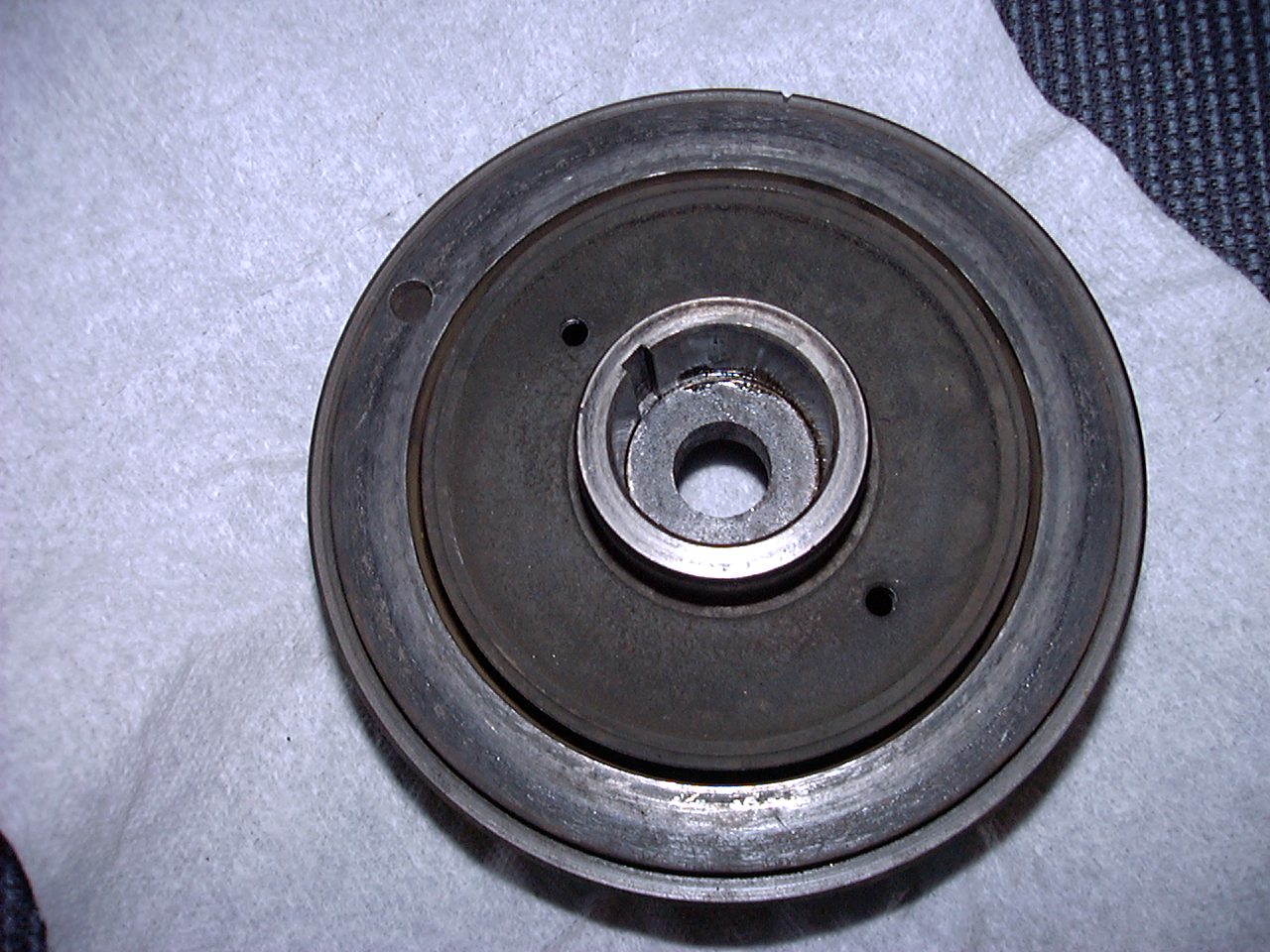

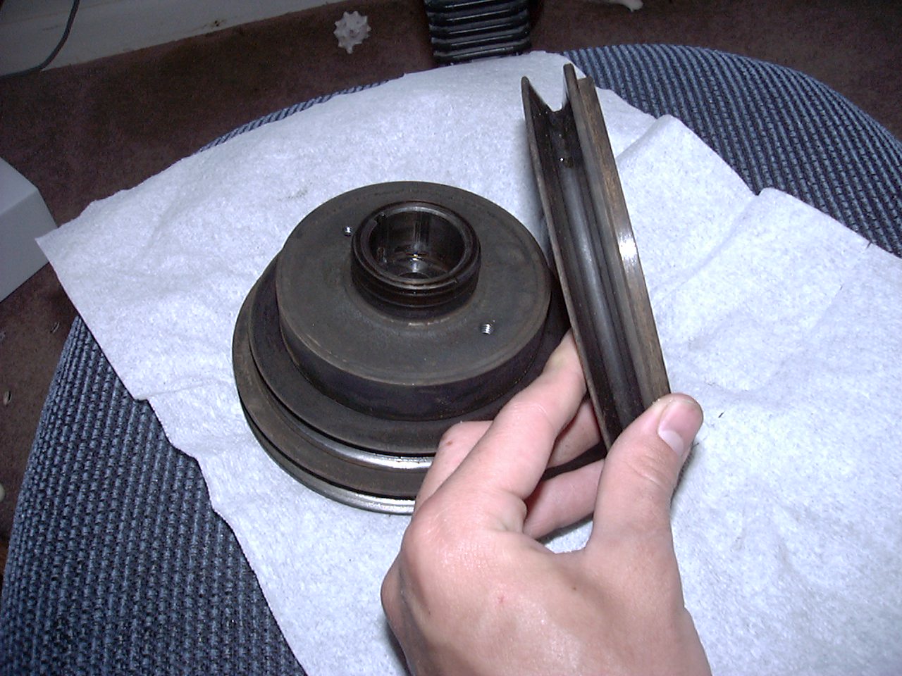

I was driving home one night, and my temp was over all the way, so I pulled over and the back part of my crank pulley was loose from the shaft part of it. The crank was spinning, but the part with my belt to my alternator and water pump was not. Does anyone know how to fix this, can I weld it back on, or if I have to replace it, how do I go about it. Also where can I find another one, mine has air pump, fan, alternator and AC compressor.

Ed, this is a late model dual pulley. I think from what he said that the larger part that drives the alternator and water pump seperated from the pulley itself.

Thanks for the help. The part that came loose was because the rubber inside of it wore off, no damaged crank shaft or anything. I talked to a z world guy about the pulley. My car had the dealer installed AC, so they had a different pulley put on. They guy told me to just go with the two belt pulley and leave off the compressor and the air pump. The radiator fan, water pump and alternator would be on the 2 belt pulley. He recommended me just buy a new one because if I get one out of a junker, the same problem will happen later. Does anyone know any someone besides MSA that sells new ones because it is about $224 for theirs.

IIRC, the part that drives the ac compressor was actually mounted on a stock pulley when they did the dealer air on the early cars. Mine is a 78 with dealer air but no smog pump so it has a two row pulley. What year is your car?
From his attachments, it looks exactly like the 240Z pulleys on my cars w/ the bolt on A/C (3rd) groove.
My car is the 1973 240z. The car has one pulley designated to the air pump, one to the ac compressor, and one to the water pump and alternator. I gave the damper doctor a call and although he didn't have the exact kind of crank pulley i needed, he is going to replace the rubber inside that holds that third pulley on, and it also comes with the 3 year warranty. Thanks for recommending him.
