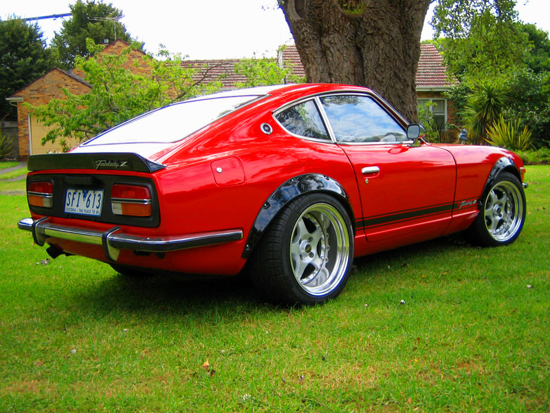

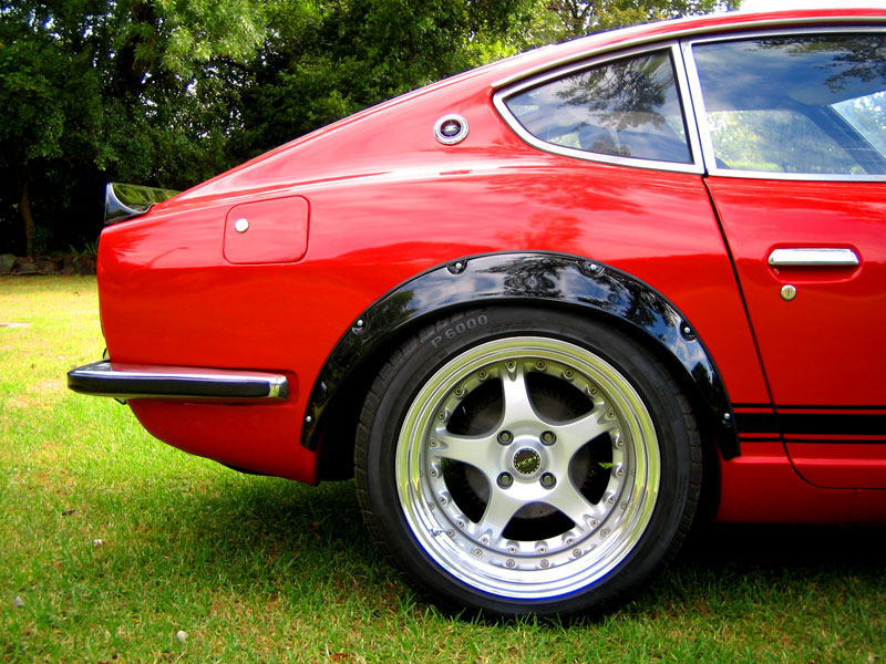

Coilovers will give you an additional 1" more tire and rim you can tuck under the body, but you don't have to use coilovers as some owners want to have the flare look. My Z already draws too much attention so I wanted to minimize the fender modification. So coilovers would let you use 8" rims but anything wider in the rear and you would need flares. BTW I am running 17x9.5 rims on all corners with 255/40-17s and coilovers and the front fenders are stock (with the inside lip rolled).
If you do your homework, you shouldn't need spacers. I'm not running spacers.
You simply wont fit wheels that wide under the stock arches. To go to those sort of widths you'd need to be using flares.
Maybe not the 17" x 10" but, the 17" x 9" will fit in the rear with the lip rolled. If you are in doubt, visit my pic gallery.
