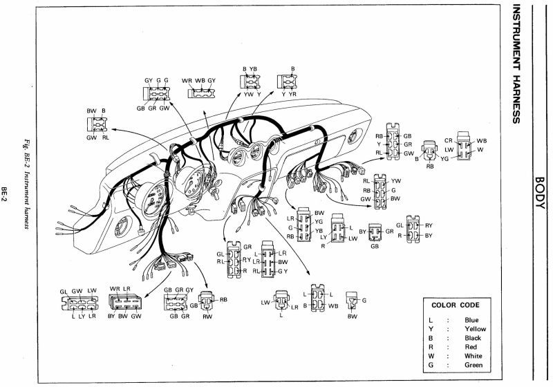

Not sure what year this is and it doesn;t have labels for the connectors, but it may help nonetheless.
I have copied this schematic. I cannot find the female connector for the defogger? It is a flat 2-prong connector. It has to be in the middle of the dash.
