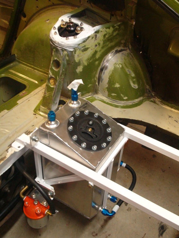

It has an Earls filter-pump and Fram filter all on it as a unit so it is heavier than it looks in the photo. I was going to hang the muffler off of it too. Diffusers aren't allowed in FP or XP. I posted a picture of Darius's diffuser on SCCA forums.com and everyone seemed to think no way. I am thinking of a Scirroco radiator in the rear though which is allowed in both FP and XP. Hmmm, if I tilt the radiator at 7 degrees like John did with his fuel cell........
A diffuser isn't allowed in ITS either, but Keith Thomas built one pretty much the way I did with a 7 degree rise on the bottom of the fuel cell. I put the muffler on one side of the cell and a flat fuel pump/filter mounting plate on the other. Worked pretty well. The 7 degree rise on the fuel cell was to make sure it meet the SCCA 6" ground clearance rule.
I made the fuel cell unit to sit on top of its mounts so I could add spacers for the 6 inch clearance rule. I am trying 23.5 diameter tires and 25 inch diameter tires in the rear. It is set up at 6 inches for the 25 and can be spaced for the 23.5.

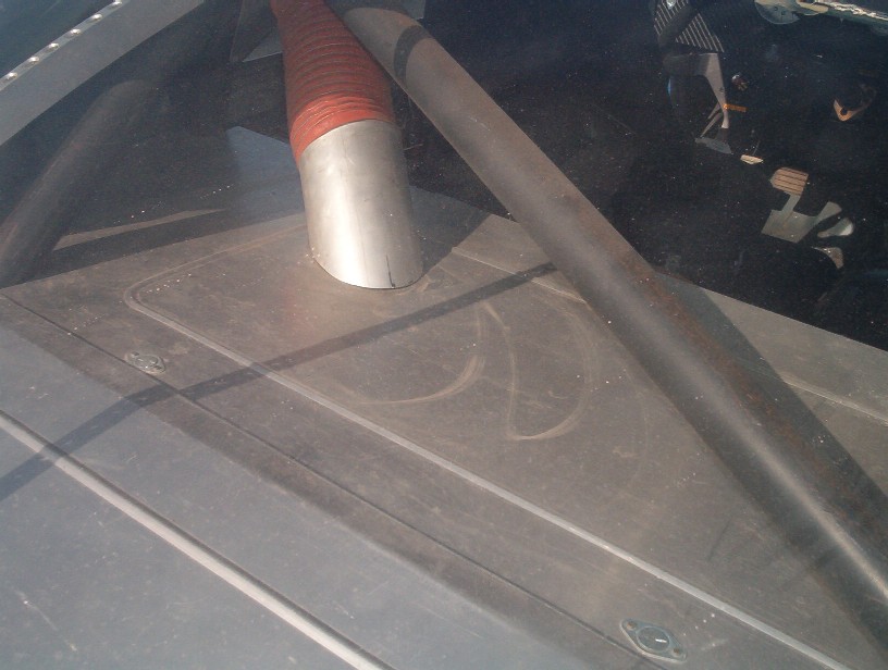

Maybe a sheet of aluminum set at 7 degrees to "route" the exiting radiator air.
