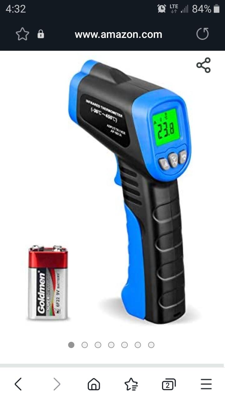

If I was you I'd buy an infared no contact thermometer and check the temperature of different areas of your car. I do not think you have percolation issues with the fuel. I do not think heat is causing your ill running car. It gets hot where I live too and my car runs fine. Did you ever get a coolant temperature with it idling and the thermostat open?
You could get readings from the carbs, the cylinder head and the block, the coil, radiator etc.
https://www.amazon.com/gp/aw/d/B07WZXK6PT/ref=sspa_mw_detail_5?ie=UTF8&psc=1&sp_csd=d2lkZ2V0TmFtZT1zcF9waG9uZV9kZXRhaWwp13NParams
