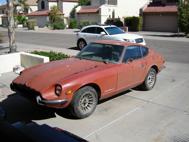

Today I got a notarized Power of Attorney and Bill of Sale from the Seller. Tomorrow I'm stopping by Arizona Z Car Source and getting some wheels & tires and heading out to the car. I'm going to have the tow-truck driver take the car straight to DMV for the Bonded Title inspection and then on to my house. With some luck I'll be vacuuming out the mouse crap by lunch time.
You guys who take on a project like this have my utmost respect. I wish I had the time and means to do a compete ground up resto of a worthy candidate like this. Perhaps one day I will. For now, I'm more than content with my 73' driver. No matter what, any car I ever own will be a driver, regardless of how rare or valuable it might be. That's what these things were made for. :) Good luck with your new project.
Yesterday I got an Arizona title for the car. I used the Bonded Title process and it wasn't that bad, the Bond is for $2,000 and cost me $75.
I never got the car to my friends shop, I kept it in my driveway so I could tinker with it. I have a vehicle storage problem and had to park my daily driver in the street, I've since moved the 280Z to my friends shop.
While waiting for the title process, I was able to get the car running. I did the Marvel Mystery oil, PB Blaster, WD-40 soaking in the cylinders each day for about a week. New ignition wires, points, oil/filter, clean & gapped the plugs with fresh gas fed directly into the pump and she fired up after about 15seconds of cranking. A little rough at first but after a few minutes the idle smoothed out somewhat and I let the car run until it was warmed up.
The following day, I let the car warm up again then did a compression test. The numbers ranged from 155 to 160 and the exhaust is clean with no smoke. I think I got really lucky here!! I'll have a leak down test performed as soon as I can get the car to my mechanic. I removed the valve cover to oil everything before I tried starting the car and was surprised that the top end was pretty clean with no discoloration or buildup of any gunk.
At this point I'm going to start removing everything from the car so I can have the metal media blasted. Here's a question for those of you that have done this; What process have you used to seal the metal after blasting? After I weld/repair any rust, do I POR 15, phosphate wash, primer, paint, undercoat the metal? Do I have the bottom and floors powder-coated? My goal is to preserve/encapsulate the metal so tha car will survive for many, many years. I'm in virgin territory here and appreciate any feedback, thanks in advance!
