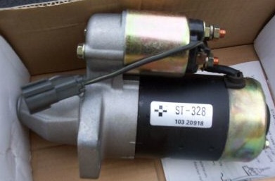

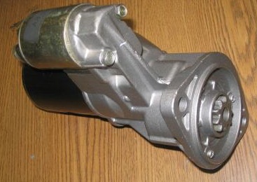

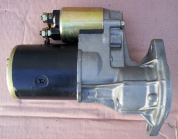

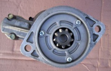

May 30, 200619 yr comment_169188 Gear reduction starters look considerably different. The first 3 pictures are all gear reduction, the fourth is a normal starter. Link to comment https://www.classiczcars.com/forums/topic/20220-starter-motor-compatability/#findComment-169188 Share on other sites More sharing options...
