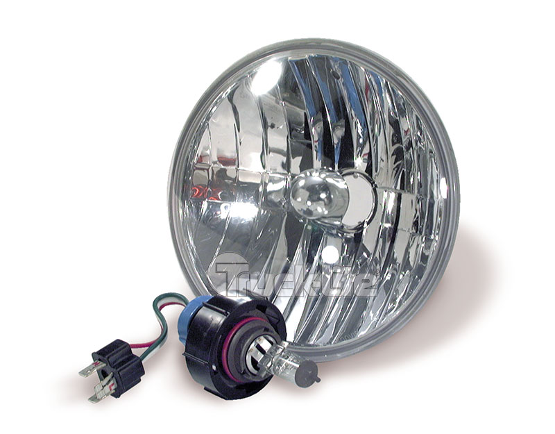

Here's what I put on the 72 I used to have. They were extremely bright when used with the relay upgrade.
http://www.truck-lite.com/webapp/wcs/stores/servlet/ProductDisplay?catalogId=10001&storeId=10001&productId=23781&langId=-1

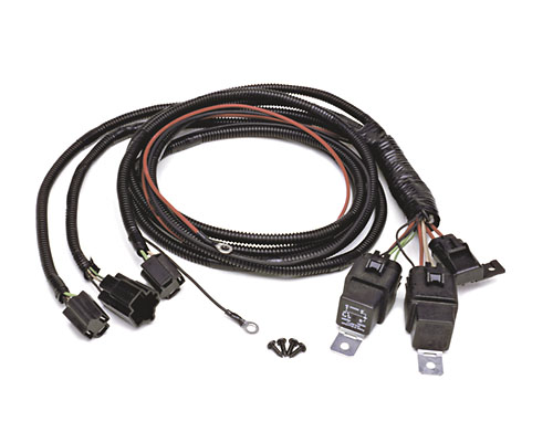

I used Painless Wiring Headlight Relay kit #30816 - For 9004 and 9007 halogen bulbs. Very painless (pun intended!).
