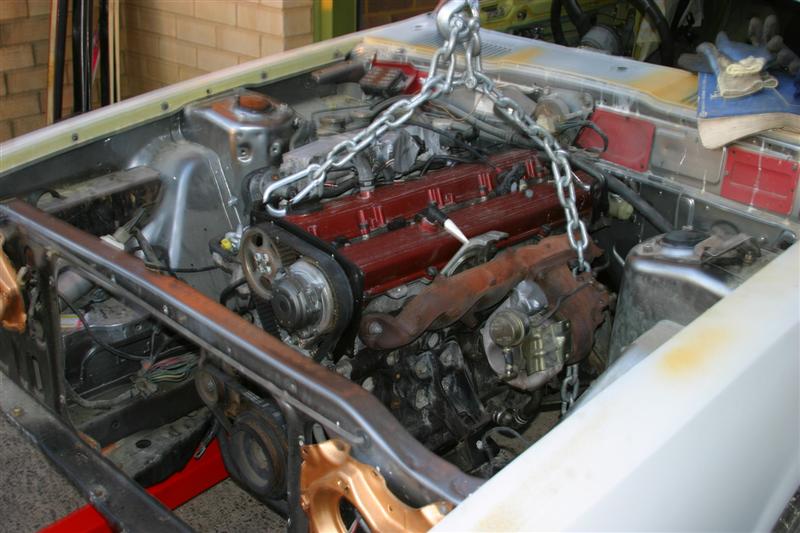

The RB series sizewise, do fit in nicely (see pic), and as you said, the RB20DET will work out a LOT cheaper. then again.. you could do an rb30 with triple webers :)
