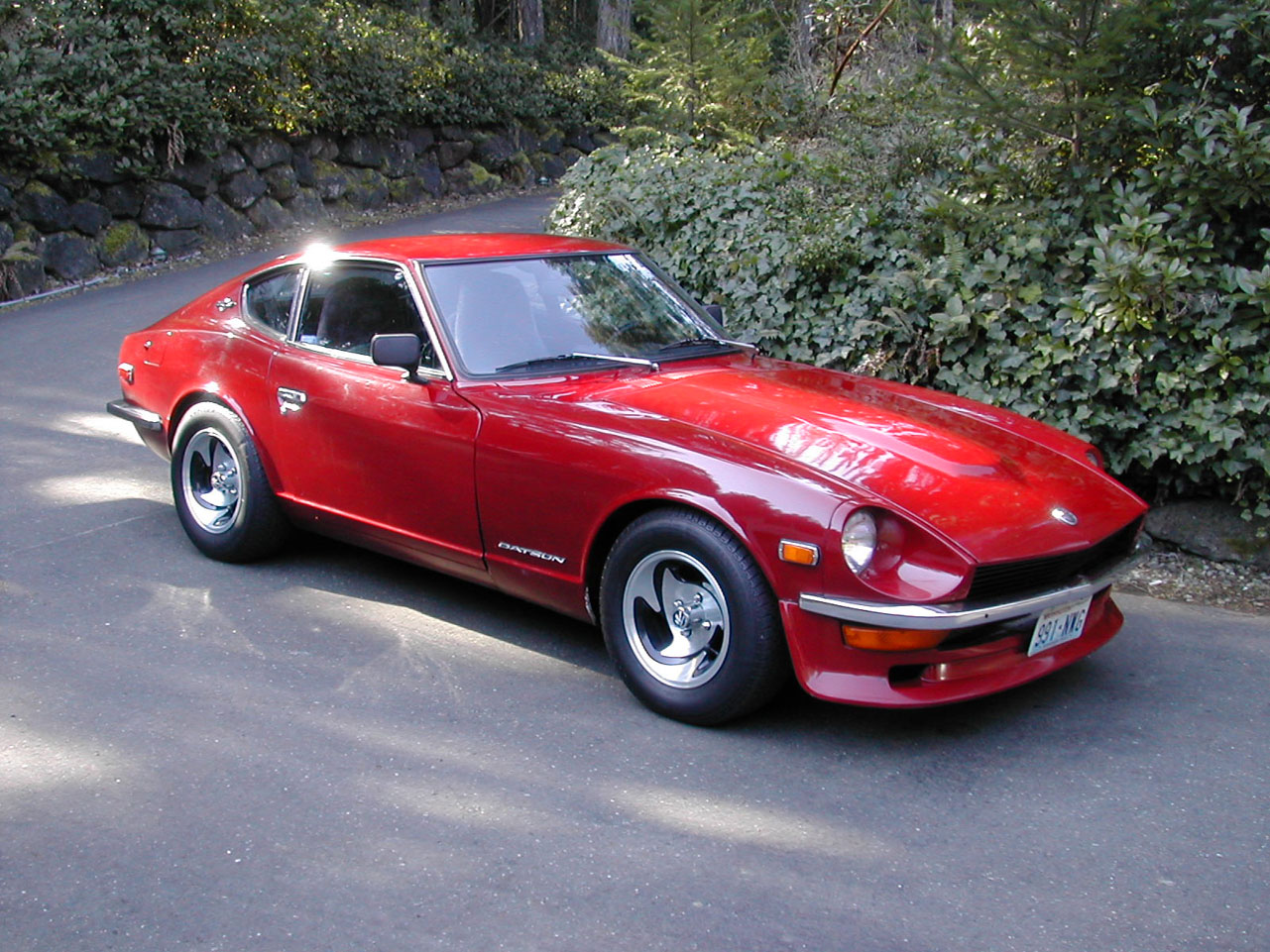

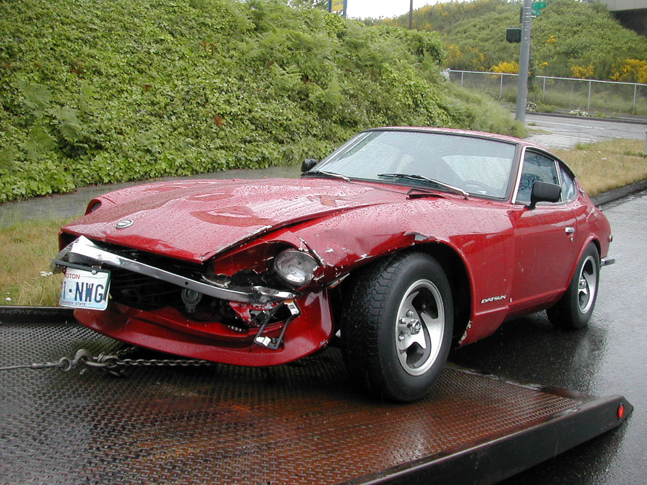

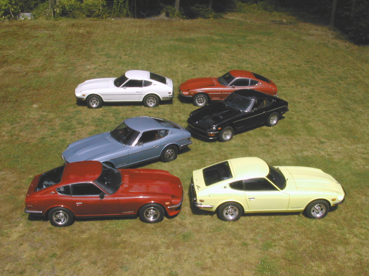

I denied myself a 240 about 18 years ago. December of 2004, all hell broke loose. I bought 3 240s that month, 3 more in January and have had 6 more as well. I have sent 2 to the recycler after stripping their rusty carcasses and sold my only 1972 240. A week ago, I had three that ran and were insured to drive, two parts cars and one project. Last Thursday, a woman ran a red light and totalled my Series I 240 built 5/70 VIN HLS30-04339. I will heal, but the the damage to the frame rails and upper/lower radiator supports cannot be fixed. :o(
I am looking at a very solid '78 280 shell. Will my 240 parts fit/bolt into the 280 body? I want to move everything, wiring, dash motor, tranny, rear end and windshield. I have to decide by Sunday, so your educated advice is very much appreciated. Hopefully, I can figure out how to add pics of my "Lil' Red Rocket".

That's a shame, looks like you had a really nice ride.
If a body shop just can't straighten that frame, get your tools out and strip that mother. You've got a gold mine in parts. :laugh:

You have a great collection. I guess you can say you got bit hard by the Z bug. Sorry about your "Lil' Red Rocket" she was a beaut.

Why can't you put a half cut on the front? Looks like all of the damage is ahead of the passenger compartment? It has been done before, and to keep a series 1 alive, it is worth doing again. If the shop doing it plans it out right, they will have very little weld finishing to do, as the bolt on sheet metal covers most of the scars. I would sacrifice one of your later driveable cars to put this one back on the road. R&R the front unibody and cosmetic sheet metal would be the right fix for your car. It would take longer and more money and tallent to straighten the car than to cut and paste...

As for the red Series I, when you look at it from the rear, the driver's side sits very low. I jacked it up from the rear differential and the passenger wheel was about a foot off the ground, before the other wheel ever left the ground. I was thinking that this meant the frame may also be twisted. As for the Series I stuff, the car came with an assortment of parts in it. Not sure how much of the tunning gear is 240 other than the R180. The dash bears a different VIN number and is a bit trashed from the punks that broke into it and stole the stereo (before I bought it). Ir has been lowered and has a 5-speed. It really hugs the corners and I liked driving it over any of the others.
I live in the Seattle/Tacoma area. I have not talked to any frame shops, because I just figured it was unrepairable. Never even considered cutting the front off of another car, I do have one that is waiting to go to the recycle yard, I will check it today for frame stability.

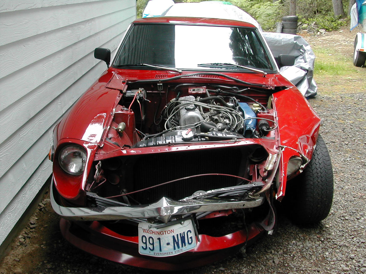

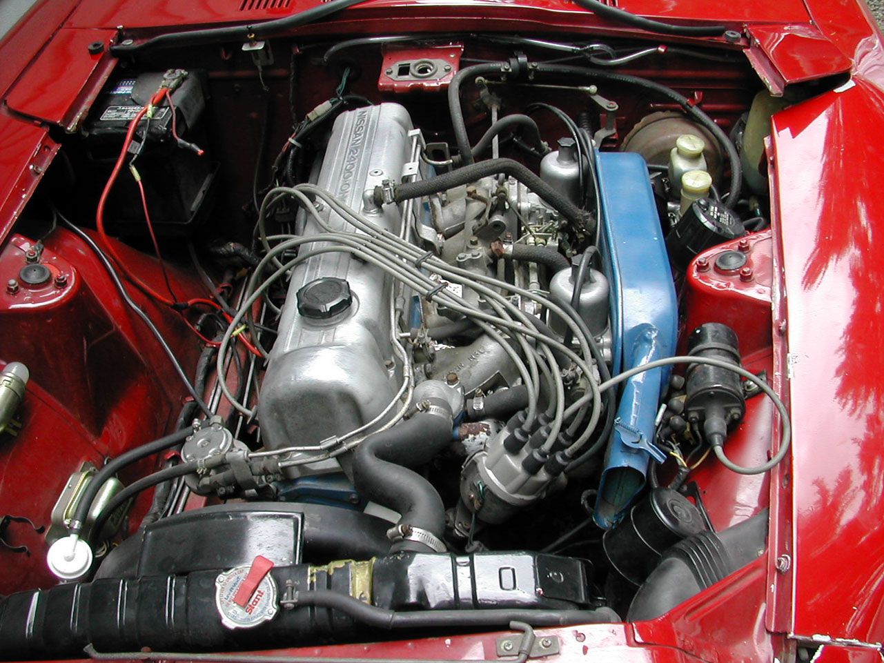

I just spent the past couple of hours pulling the front pieces off. Getting the air cleaner off was a real chore due to the fact that the strut tower was about an inch away. The radiator (3 or 4 row) can be fixed and the L24 w/E31 head looks untouched. I don't think I am going to go through the hassle and expense of putting a new front end on it. If anyone is interested in the shell, I'm open to offers. Otherwise, I will be parting it out. I'll put the motor, 280 5 speed and all running gear into another 240 shell. The spirit of my Lil' Red Rocket will live on.
BTW. The car is rust free. That's what really pisses me off.
