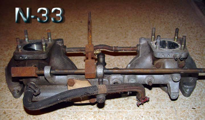

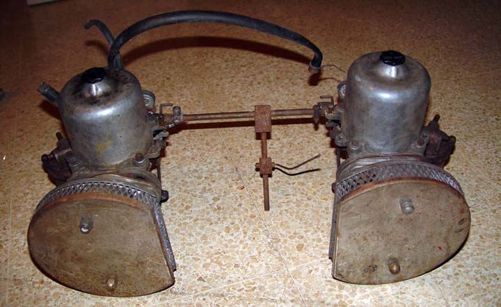

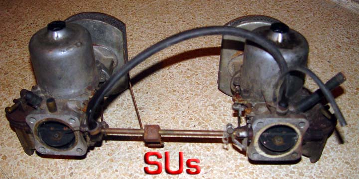

Well after being reading these answers I have to change my mind since the E88 doesn´t have the best compression ratio. I should milling or swap to L28 Engine.
Also have some pics fromthe SUs I have. They look grrr now but if I polish them and rebuilt can bring them back to life.
Or please if someone can help me setting up a E88 for the more power I can get.
I want my car for weekends only but is for street. A powerful street lady.
Thank You.
This site is the best TONZ OF NIZE PEOPLE.
I haven't been using SU's for 6 or 7 years, but those don't look right. The air cleaners look like ones I've seen on the smaller 510 SU's. And the oil caps on top look strange too. You might want to measure the opening in the manifold side of the SU and see how large they are. Someone here will know for sure but I think the stock Z car SU's are 42mm.
Ztherapy carb will bring the life back to your motor. They are great carbs and the video that comes with them will educate you in every way in relation to the SU's. You might not get the power potential of tripples but they are less than 1/2 the $ and you can get a lot of power from them. I would stay away from the SM needles unless you have a larger cam and head work done, they run too rich on the higher rpms.
