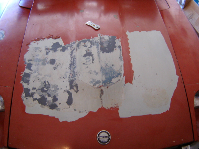

When I read Theianmonster's reply of using a razor blade, I thought, there's a crazy idea!!!
Then I went down to the car and tried it, works great. The left side of the picture was stripped with paint stripper, took 15 minutes plus the cleanup. The right side of the picture took about one minute, a little vacuuming and no odors.
After this worked so well, I tried a number of other areas that weren't as flat, same results.
