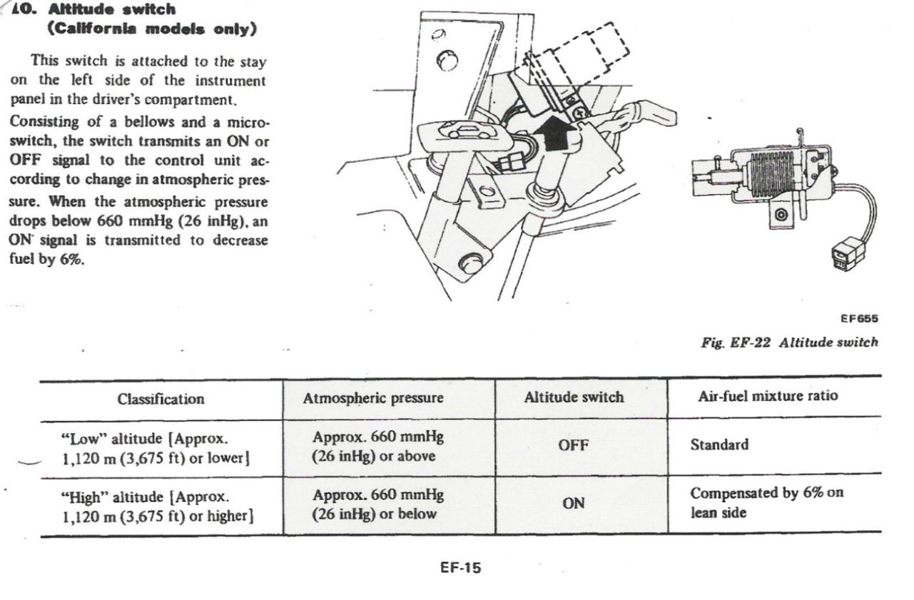

The reason I'm asking all this is because when I push in the clutch to shift while driving, the car revs up about 500rpm...
It's on all 280Zs and 810 regardless of transmission. I don't know where Grim got the notion that it only existed on AT cars. No vaccum connection. They removed them when they came out with the ZX and the Maxima. All it does is is what 280~Master said. And from your description, yours is working properly. Is your car by chance a California car. I only ask because the 500rpm thing you speak of is symptomatic of a badly adjusted altitude corrector but those are only on the California cars.
As a matter of fact my car did come from California! That's amazing! You must really know your stuff. Can you tell me where is this altitude corrector located and how to properly adjust it?? It is quite annoying when I want to shift or just roll to an idle...

I shouldn't have said badly adjusted when what I really meant was malfunctioning. The altitude corrector is located on the drivers side near the hood release. It compensates for alititude by leaning the fuel mixture by 6% above 3675 ft. When they don't work properly, they can cause the idle to hang up for a while before it settles to normal. You could replace it but most commonly, people just disconnect it which solves the idle problem but you lose the altitude compensation. Part number 22612-N4800.
