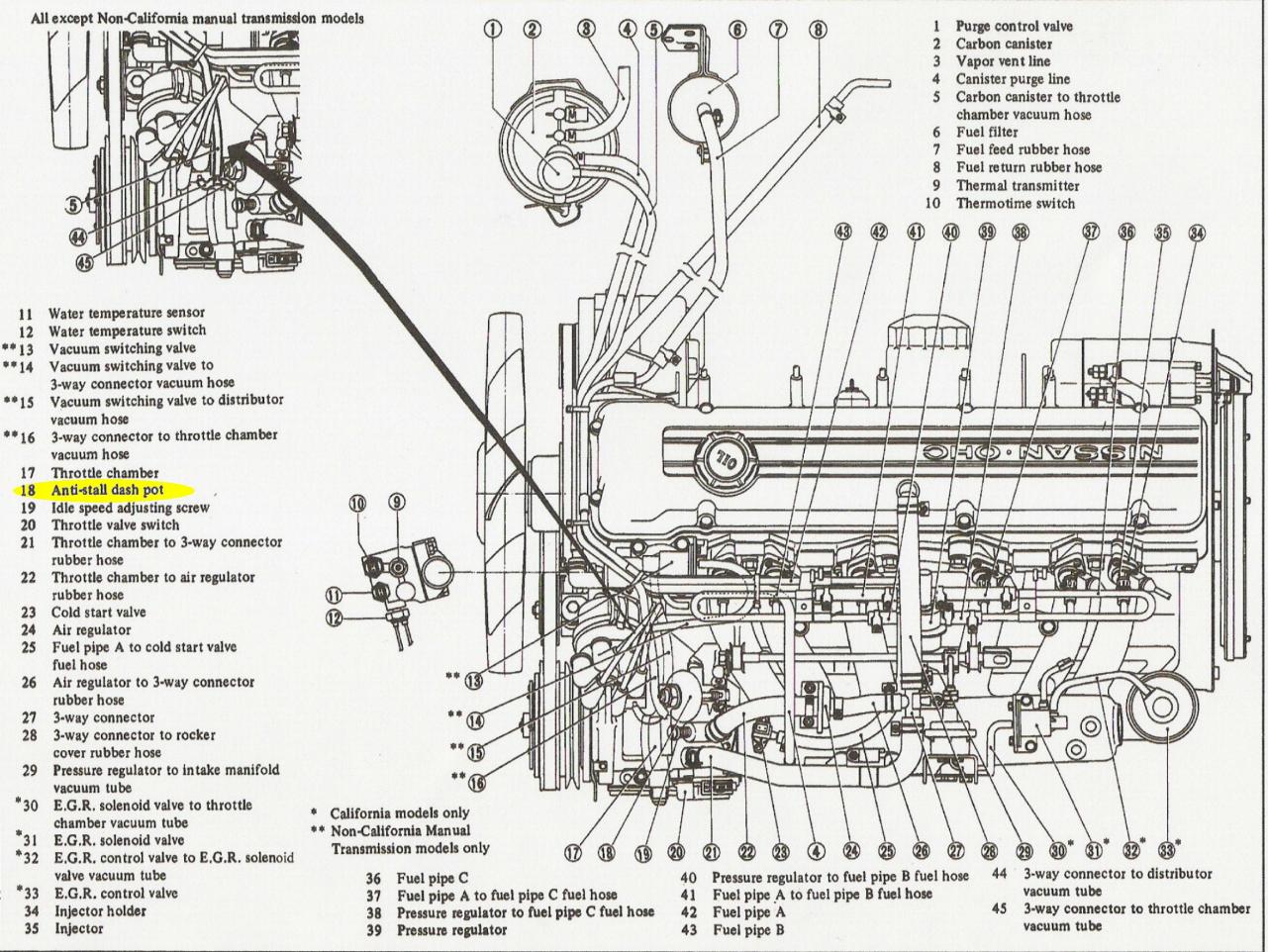

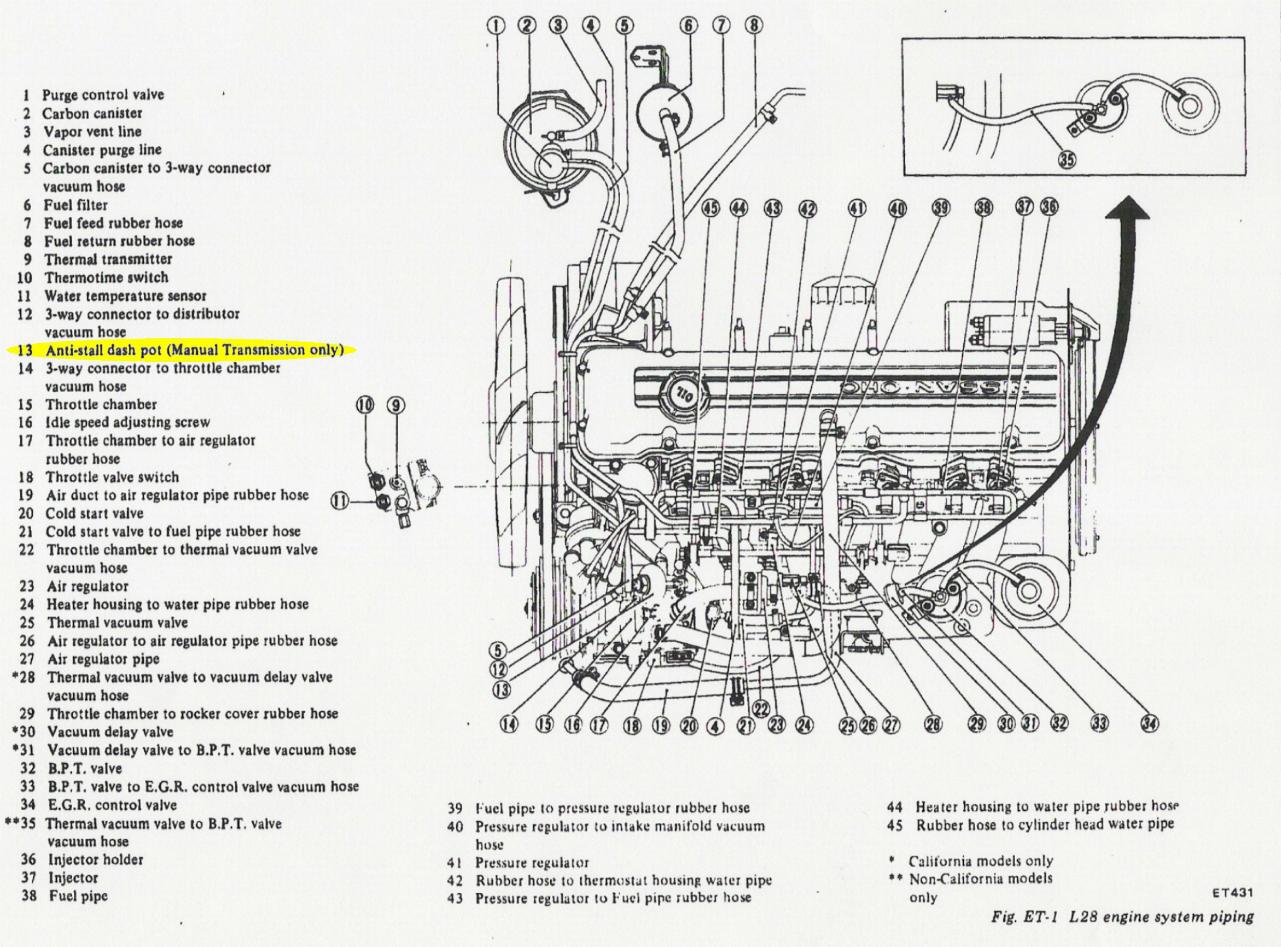

What makes this all seem rather strange is that the original post is about an automatic car that was converted to a manual. And it has the dashpot and hence my original statement. The FSM says manual trans only for the dashpot, but my 'junkyard research' says that that is not true.

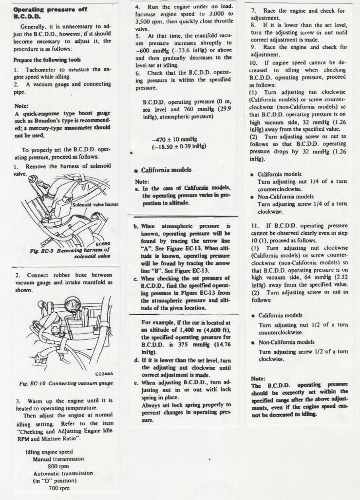

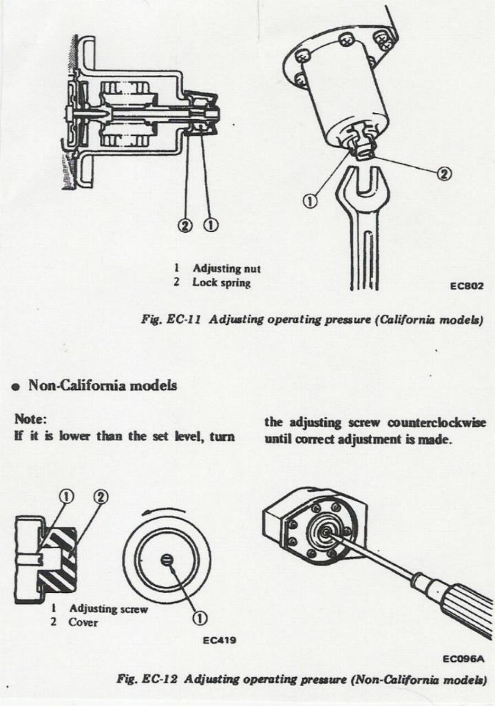

Grim, I stand corrected. I just did some reading. FSM, page ET-3. Manual transmission only. But, one more correction: Tomohawk, the BCDD can be adjusted. See page EC-7 & EC-8 in the FSM.
If the instructions from the FSM aren't too long for the adjustment of the BCDD, could you post them? I am still in the process of finding a '78 FSM at a reasonable price and only have the chilton manual.

The rare times I've seen Automatic 280Z's do not have the Dash Pot and the Factory Service Manual is not going to lie either so I have to agree it's got to be on Manuals only. If your Automatic models have it then possibly the previous owners did some parts swapping from a manual model? My guess anyways.

The service manual is not going to lie? Well, I don't think it's lying but there are many inconsistencies when you deal with these cars. Take a look at these two scans, both from FSM's. One makes no mention of transmission type and the other does.
