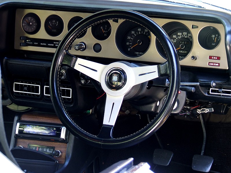

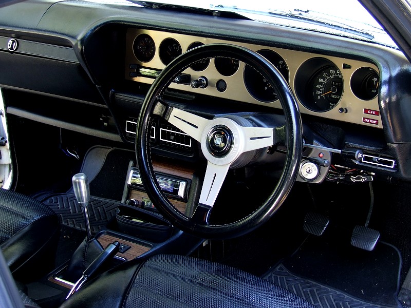

BTW Here are some pictures of the wheel installed (haven't got the horn working yet, but I have a plan).
cheers for the help guys, all easy when u know what you're doing! woulda taken me forever to try twisting the horn pad, i wanted to mangle it with a screwdriver :)
and yeah, disconnected the battery (after hitting the horn numerous times!) will take some pics tomorrow, horned doesnt work but i'm not fussed about that, donno about the indicators yet as the car doesnt have any interior besides the dash so i cant take it for a test drive, waiting to get my race seats, hehe
Lachlan,
See if you can fit a small spring over the post. It looks like there's a groove in the middle of the post that will hold the spring. Just make sure to get something soft, like brass and not stainless steel.
The wheel looks great! Better than when it was in my car. Must be that stainless finish dash.
