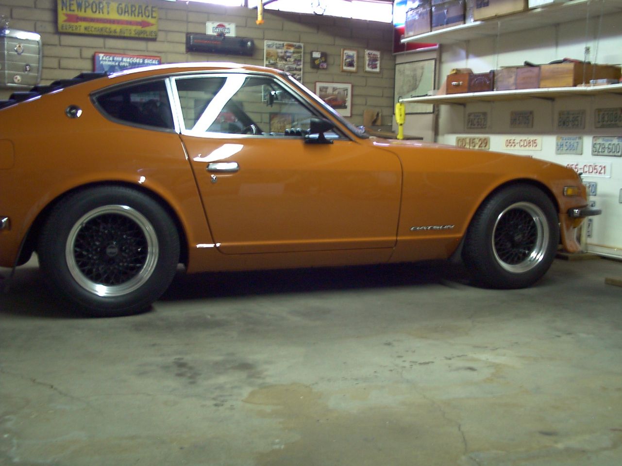

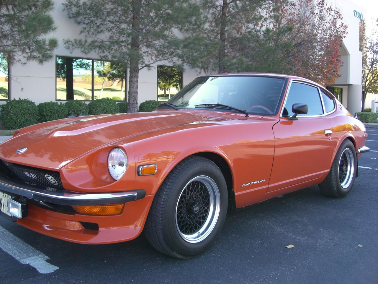

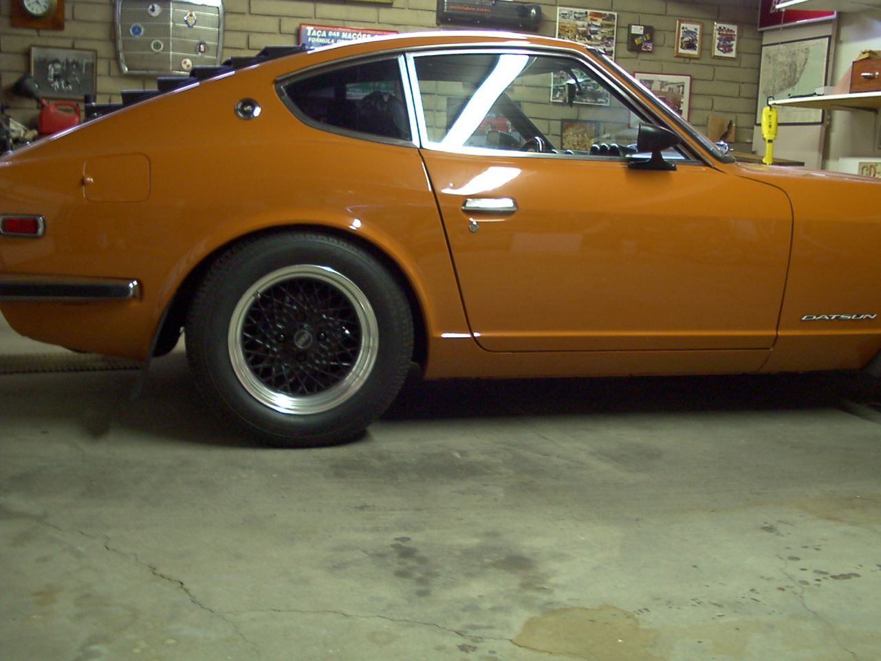

Don't understand why you might have a problem with Tokico shocks. I have them on my 73, and the car lowered about 3 cm. The shocks/springs combination is just great. Best I have ever had on the car and I have tried many combinations.
Here's a photo with 15 inch tires.....
You might notice the 055 CD plates... spent many years in Portugal and absolutely loved your country....
